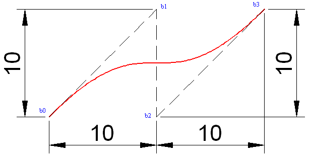

spinecad Posted March 24, 2013 Posted March 24, 2013 What kind of Bezier curve is such as the attached image that has 7 points? Quote
SEANT Posted March 24, 2013 Posted March 24, 2013 It could be a degree 6 Bezier curve, but more likely is a degree 3 NURBS curve. Quote

spinecad Posted March 24, 2013 Author Posted March 24, 2013 For the given NURBS curve as attached image where b0, b1, b2, b3, b4, b5, and b6 are the control points, which one is called by the knot vector? Quote
SEANT Posted March 24, 2013 Posted March 24, 2013 (edited) The Knot Vector is somewhat of a "behind the scenes" component of a spline. Used only for the mathematical basis function. If the spline you have illustrated above was created with the CV option of the SPLINE command then the Knot vector will be: 0,0,0,0,1,2,3,4,4,4,4 The Fit Point option of the SPLINE command will create varying Knot Vectors depending on the setting for the Knot Parameterization. The default Knot = Chord would create a Knot Vector: 0,0,0,0,Length(b0 to b1), Length(b0 to b1 + b1 to b2), Length(b0 to b1 + b1 to b2 + b2 to b3)), etc. The last four entries would be the length of the entire b0 to b6 polyline repeated four times. Edit: I included a couple of additional knots that are not required. Edited March 24, 2013 by SEANT Quote

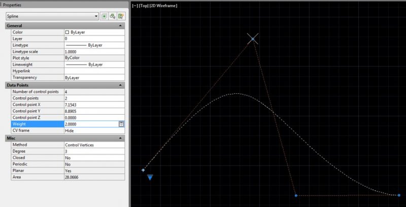

SEANT Posted March 24, 2013 Posted March 24, 2013 Weight are fairly straightforward.* Experiment by changing the weight in the Properties Panel to see how they affect the spline. While manipulating splines in the drawing editor, Knots and Knot Vectors don't really come into play much. Knot play a much larger role when working with spline in the computer programming phase. Knot features are probably the most visually evident when several splines are combined with the JOIN command. If the "joined" spline has a kink, that is indication of a recurring knot value at that point in the knot vector. I posted a routine here that creates a circular spline by varying the weights and knot vector of a NURBS curve. http://www.cadtutor.net/forum/showthread.php?32338-Splined-Circles *Saddly, AutoCAD has a bug that makes manipulating spline via dragging a weighted control vertex quite difficult. Quote
