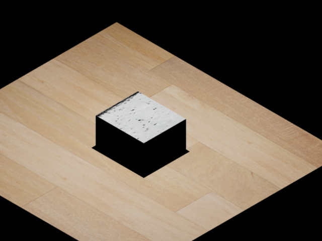

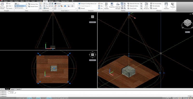

OckMc Posted March 23, 2013 Share Posted March 23, 2013 (edited) Hi all, I'm trying to learn how to use lighting in AutoCAD but when i place the light in my drawing i can't see it. I have made sure the light is on and the default lighting is turned off but still i can't see it. I tried to render it presentation style but still nothing. Can anyone help me out? Attached is a screenshot of what i am trying to do. Edited March 23, 2013 by OckMc Quote Link to comment Share on other sites More sharing options...

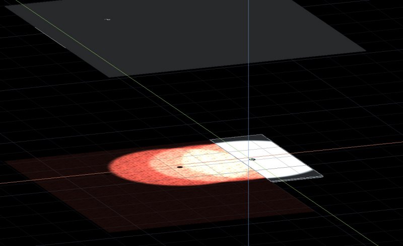

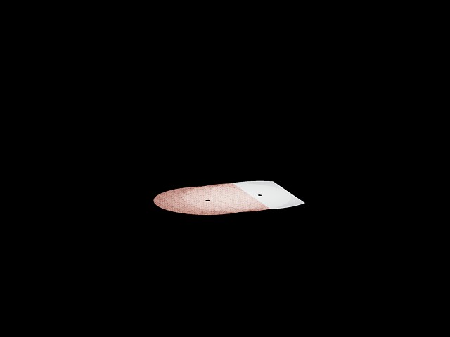

Rewind23 Posted March 23, 2013 Share Posted March 23, 2013 @OckMc - I tried a test render regarding your problem. Btw, make sure you aligned your light/lights properly to the object that you need to render. In my test render I use a spotlight with default values and then I just hit render and this is what I got.Please see picture below. Quote Link to comment Share on other sites More sharing options...

Rewind23 Posted March 25, 2013 Share Posted March 25, 2013 @OckMc - Please see the attached file. What happen to your lighting is it has a very low value, so I adjusted the intensity until I get the lights rendered. Please see picture below. Btw, I also notice that your plane is in -Z value, in AutoCAD always start placing ground objects on a 0,0,0 value. Regards House02 Lighting Setup2010.dwg Quote Link to comment Share on other sites More sharing options...

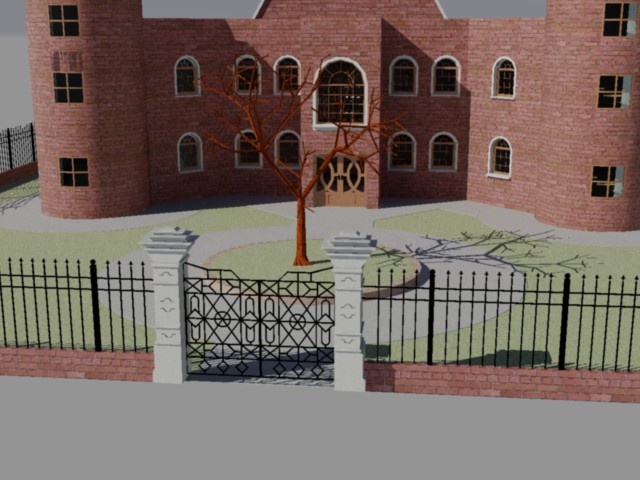

OckMc Posted April 11, 2013 Author Share Posted April 11, 2013 Well i managed to finish my model. Unfortunately my computer keeps crashing every time i try to render the anipath i had planned to make which would have shown the internal features. Very frustrating process i must admit. I think i still need to upload the intensity of my lights another notch or too but overall i'm happy enough with it. Any good render farm suggestions? Quote Link to comment Share on other sites More sharing options...
Rewind23 Posted April 11, 2013 Share Posted April 11, 2013 [ATTACH=CONFIG]41363[/ATTACH] Well i managed to finish my model. Unfortunately my computer keeps crashing every time i try to render the anipath i had planned to make which would have shown the internal features. Very frustrating process i must admit. I think i still need to upload the intensity of my lights another notch or too but overall i'm happy enough with it. Any good render farm suggestions? Hey! the render output looks good to me. I like the material mapping result of the bricks. The lighting looks like 11am here in the Phils.(atleast to me) By the way, What is your system specs? You have to take note that a rendering process consumes most of you're computer CPU & RAM. There are possible reasons why system is crashing, things to consider are heavy loads of 3d objects in you're render, overlapping objects(duplicate) that slows down AutoCAD, though OS might play a little with the problem, Are you using 64bit OS? Also, what video format you're using? Try to save the animation using the other video formats available I think there were 3 WMV,AVI &MPG try to play with those. And what do you mean by Render Farm suggestion? Are you talking about Computer Hardware Specs for rendering? I personally recommend to invest into something that is beneficial for rendering, get an Intel Corei7 or Corei5 quad CPU atleast for the rendering and it will follow other computer parts like GPU,RAM,MOBO(motherboard) & don't forget a reliable PSU(power supply) compatibility issue with those computer parts should be consider. Unless, if you're planning for a workstation there are several brand names like Dell,HP & Lenovo. Just make sure to read some reviews of computer parts & specs over the internet & PC forums before you purchased it, It will help you a lot in you're decision making. I'm planning for an upgrade soon, cause I'm still stuck with my old Dual-Core CPU. Quote Link to comment Share on other sites More sharing options...
tzframpton Posted April 11, 2013 Share Posted April 11, 2013 [ATTACH=CONFIG]41363[/ATTACH] Well i managed to finish my model. Unfortunately my computer keeps crashing every time i try to render the anipath i had planned to make which would have shown the internal features. Very frustrating process i must admit. I think i still need to upload the intensity of my lights another notch or too but overall i'm happy enough with it. Any good render farm suggestions? You don't need a render farm. I mean, if you WANT one, then by all means but if what you're doing is personal use, then there's really no need. Cheaper alternatives are just a dedicated computer for rendering, DIY Render Farms (Google this for more info), or an online render service where you upload a file, and "ding" it's done. And ANIPATH is somewhat horrid. I don't get a kick out of bashing AutoCAD but sometimes they don't offer a great solution. Other programs can (and probably should) be used for Walthrough and Flyover animations. Quote Link to comment Share on other sites More sharing options...
Rewind23 Posted April 11, 2013 Share Posted April 11, 2013 You don't need a render farm. I mean, if you WANT one, then by all means but if what you're doing is personal use, then there's really no need. Cheaper alternatives are just a dedicated computer for rendering, DIY Render Farms (Google this for more info), or an online render service where you upload a file, and "ding" it's done. @OckMc - I agree with StykFace. He's right if its for personal use then invest for a personal workstation (I mean build your own rig), in a sense its much cheaper DIY render Quote Link to comment Share on other sites More sharing options...
Cad64 Posted April 11, 2013 Share Posted April 11, 2013 Any good render farm suggestions? Unless something has changed with the latest releases, Autocad does not have the capability to network render. You would need to use a program like Studio Max, with it's Backburner network render manager, if you want to utilize a render farm. Quote Link to comment Share on other sites More sharing options...

OckMc Posted April 11, 2013 Author Share Posted April 11, 2013 Cheers for all the feedback folks tis much appreciated. @ Rewind23 What i meant when i mentioned the lighting is that there are 24 lights inside the house but i still can't see them in rendered images. I had the light intensity set to 120 which i changed to 350 but still nothing. My machine is an Intel Core i3-2120 CPU @ 3.30 GhZ. It was put together by a friend specifically for 3D Cad but I think I will probably have to upgrade it a smidge. I was careful when I put the model together to avoid duplicates but i think there are over 20,000 components overall. 11,000+ are in the fencing alone. Tomorrow i'll remove the fencing and try to render another clip but not getting my hopes up AutoCAD is gone so buggy right now it's doing my head in. Video format is .avi because they are compatible with Youtube. Obviously if i thought it could be done on the cheap I would use a render farm, again I'll look at it tomorrow but judging from the sites i looked at today Cad64 is probably right about Cad not being network render compatible. I am keen on being able to make these clips though. I am currently trying to find work as an Architectural Technician or 3D cad drafter so I'm trying to put together a showreel of sorts. In the past I studied construction where I learned 2D CAD, it is only in the last three months i have started learning the 3D side of things in my spare time so any tips or suggestions are greatly welcomed As far as other programs go I've never used Mental Ray or 3D Studio Max but I am starting a course on the latter in June. Quote Link to comment Share on other sites More sharing options...
tzframpton Posted April 11, 2013 Share Posted April 11, 2013 A Core i3 is a very low wattage CPU. Granted, the i3 class CPU is great for what it was intended to be used for, but it is anything but the CPU you would need for 3D Rendering. I mean, not even in the same class at all. High end Core i5 is an absolute bare minimum for standard performance if you're going to be rendering 3D geometry in realistic visual representation, which clearly you are if you have 24 lights in a model. Just my $0.02 FWIW. Good luck in your courses and endeavors. We're all here to help. Quote Link to comment Share on other sites More sharing options...
