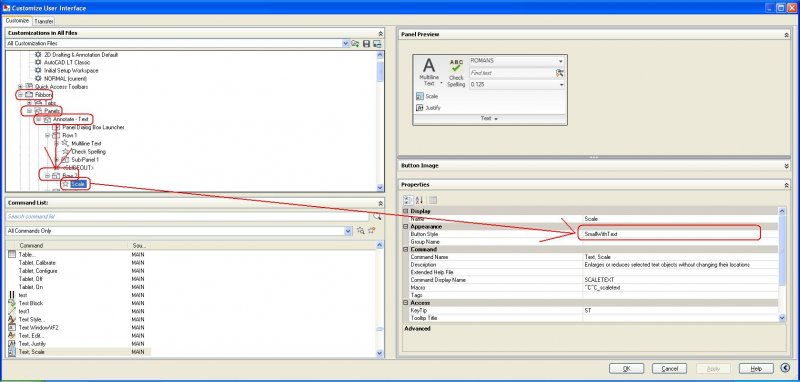

I want to remove the text that is to the right of the icon on the Modify Panel. Since AutoCAD has been using these icon since R14... I dont need them to tell me what the move icon is.. ;-)
I did search 'CUI, Panel, Text' but no results.
Help please.
Browse to where the button/command is located in the CUI; Ribbon->Panel->PanelName->Button. Should be an option in right side for "Button Style." I believe that's what you're looking for.
HTH
