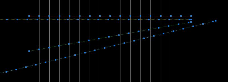

i been testing the code with stations that i will acounter for sure and find that the points positioned precisely on stright ortographic polilynes only where the path distance is equal to the polyline length(RED LINE)
in all other polylines as you can see in the image the points are not position correctly
what can i do?
Thanks
Shay
Attached

Still not sure.
Try this demo:

Hello
Im in work
I have snatch it andin first glance it seems exactly what im after
I saw also lots of new things for me to learn in your code
God..how did you manage to shorten my code like this….welldone!
Billion of thanks dude
I wish to be like you one day !
Shay

Supplying an interval along the "curve" (the lines) to get the coordinates , getPointAtDist will not work in this case
as you have lines of varying angles (image at post # 21). plus the fact that startpoint varies as well.
Got it?

          (setq int (getdist "\nEnter Interval:"))
          (setq in int)
   (while (Setq pt (vlax-curve-getPointAtDist pline int))
     (setq ppt (vlax-curve-getparamatpoint pline pt))
     (vlax-invoke
       (vlax-ename->vla-object pline)
       'AddVertex
       (1+ (fix ppt))
       (list (car pt) (Cadr pt))
     (setq int (+ int in))
This works fine on polylines where all segements are just straight. But if I have a polyline with arcs it will remove the arc and replace it with straight segments at the specified distance. Is there another version of this that also works on polylines which contain arcs?
Feargt
Here, try this - not tested, but it should work...
(defun c:demo ( / add_vtx pl int in pt flag )
 (vl-load-com)
 (defun add_vtx ( obj add_pt ent_name / bulg )
     (vla-addVertex
         obj
         (1+ (fix add_pt))
         (vlax-make-variant
             (vlax-safearray-fill
                 (vlax-make-safearray vlax-vbdouble (cons 0 1))
                     (list
                         (car (trans (vlax-curve-getpointatparam obj add_pt) 0 ent_name))
                         (cadr (trans (vlax-curve-getpointatparam obj add_pt) 0 ent_name))
     (setq bulg (vla-GetBulge obj (fix add_pt)))
     (vla-SetBulge obj
         (fix add_pt)
             (sin (/ (* 4 (atan bulg) (- add_pt (fix add_pt))) 4))
             (cos (/ (* 4 (atan bulg) (- add_pt (fix add_pt))) 4))
     (vla-SetBulge obj
         (1+ (fix add_pt))
             (sin (/ (* 4 (atan bulg) (- (1+ (fix add_pt)) add_pt)) 4))
             (cos (/ (* 4 (atan bulg) (- (1+ (fix add_pt)) add_pt)) 4))
     (vla-update obj)
 (setq pl (car (entsel "\nSelect pline entity")))
 (if (not (wcmatch (cdr (assoc 0 (entget pl))) "*POLYLINE"))
     (alert "\nPicked entity isn't polyline - quitting")
     (exit)
   (if (and (or (eq (cdr (assoc 70 (entget pl))) 0) (eq (cdr (assoc 70 (entget pl))) 1)) (eq (cdr (assoc 0 (entget pl))) "POLYLINE"))
       (setq flag T)
       (command "_.convertpoly" "l" pl "")
     (if (not (eq (cdr (assoc 0 (entget pl))) "LWPOLYLINE"))
         (alert "\nYou picked 3d polyline - quitting")
         (exit)
 (setq int (getdist "\nEnter Interval: "))
 (setq in int)
 (while (setq pt (vlax-curve-getPointAtDist pl int))
   (add_vtx (vlax-ename->vla-object pl) (vlax-curve-getparamatpoint pl (vlax-curve-getclosestpointto pl pt)) pl)
 (if flag
   (command "_.convertpoly" "h" pl "")
M.R.
Thank you Marko,
works a treat!
