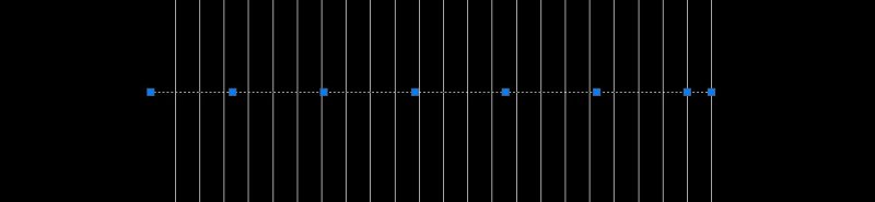

code ask for point a and b and for polylines, than it sends points a and b to be divided and returns what is the segment length and the number of segments. than it adds verts as the number of the segments and (suppose to) distribute them in segment length interval
you can see the xlines are distribute correctly but the verts are not. i want the verts to be distribute exactly as the xlines

the problem:
for some reason the verts are not distribute correctly, the segment length should be the interval but its not

you can see those points? they supposed to be destitute exactly like the lines.

samifox, after examining your code, me think you should change
(setq in segcnt)
to
(setq in seglen)
After, you should test your code again...
M.R.
Mario...do you know you are my king!!!
Thank for reading thru all the thread
You make my day
God bless you
