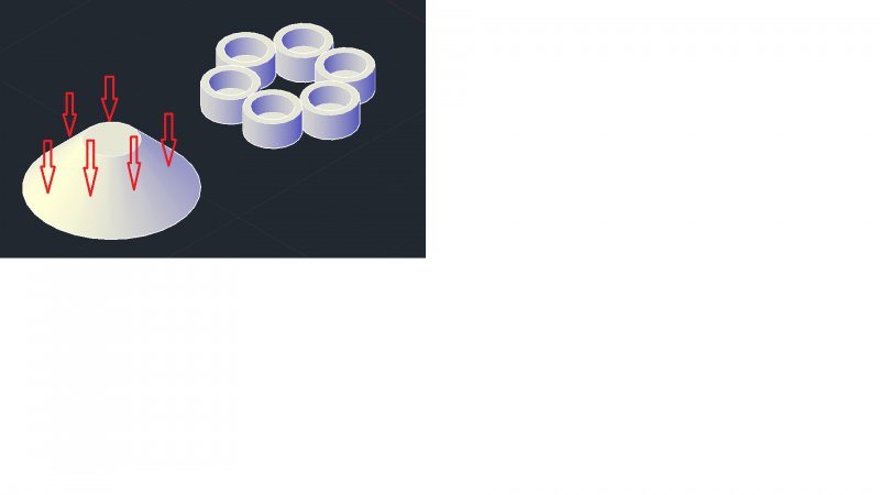

nic6911 Posted March 21, 2013 Posted March 21, 2013 Hi. I am trying to place some objects on a cone. But i can't get it to work. The idea is that the 6 objects should be fitted on the cone so that they are placed all around the cone. But i can't get them to align with the angle of the cone. I have tried the 3D align, but this just doesn't work for me. Regards Nic Quote

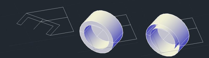

tzframpton Posted March 22, 2013 Posted March 22, 2013 Ah yes, good point TKall. I didn't read thoroughly enough to notice the original poster might have wanted to truly align the smaller cylinders on the cone. Attached is a quick and dirty example. If this is the results then I can go step by step but my above post wouldn't apply for most of it. Cylinder Test.dwg Quote

nic6911 Posted March 22, 2013 Author Posted March 22, 2013 Stykface That is precisely what i want. I want to align the cylinders on the cone. I want to do what you have done in the drawing you posted. But how did you do that? Regards Nic Quote

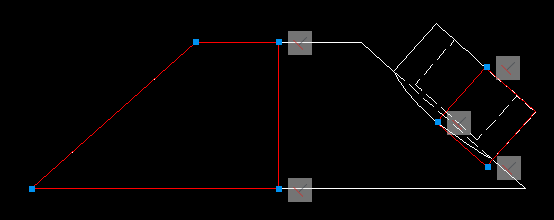

JD Mather Posted March 22, 2013 Posted March 22, 2013 This is a fairly simple geometry problem if you draw the 2D profile, Revolve, Revolve, Subtract, Polar Array If you already have solids that you want to Align, this same 2d profile (red - I drew on opposite sides only for clarity) can be used. No calculations required (I try to avoid calculations whenever there is a geometric solution - which is most of the time). Quote

JD Mather Posted March 22, 2013 Posted March 22, 2013 Of course it isn't really required to use geometry constraints for this solution, but I like to nail things down to avoid mistakes. Quote
