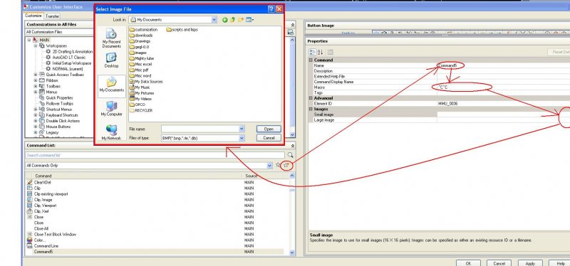

bgingerich Posted March 20, 2013 Posted March 20, 2013 This link and the attached screenshot should help some with the images. The first circle is the 'new command' button; name the command, specify the code to run, then specify a saved image (.bmp) for the button. http://docs.autodesk.com/ACD/2011/ENU/filesACG/WS73099cc142f4875513fb5cd10c4aa30d6b-7d76.htm HTH Quote
Tyke Posted March 20, 2013 Posted March 20, 2013 If you open the CUI in the bottom left pane under the magnifying glass there is a button with a star and an asterix as symbol. If you click on that it creates a new command (blank button). It is advisable to rename it and its name starting with an underline so that always is at the top of the command list. You can drag this blank button to where you want it and fill in the blanks, so to say. Quote
dbroada Posted March 20, 2013 Author Posted March 20, 2013 Thanks, I have just found that and have just finished my screenshot, came back to post it and there was your reply! Still, its far nicer for somebody else to answer than be here just talking to myself. ===================== those thanks were for bgingerich. Tyke could have answered back when he was thinking about beers at Easter. Quote
