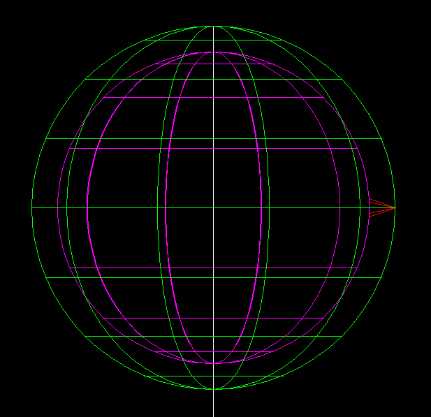

dayongli86 Posted March 21, 2013 Author Posted March 21, 2013 Thanks again, Sir. attached please find the image which I have created sphere and cone shape. I can see the bottom of cone is very close to the surface of sphere, but still have gap. You will be highly appreciated if you can coach me how to extend the cone to the surface of sphere, so that I can measure area of intersection line, and would like not merge this two objet, so we adjust the location of cone. Thanks in advance for your great education. Quote
ReMark Posted March 21, 2013 Posted March 21, 2013 To actually and fully touch the surface of the sphere wouldn't the bottom of the cone have to be concave? Quote
dayongli86 Posted March 21, 2013 Author Posted March 21, 2013 Yes, that is exactly what I want. Could you please coach me how to get it? Quote
ReMark Posted March 21, 2013 Posted March 21, 2013 Your cone has to extend into the sphere. Then use either the Subtract command or the Slice command with the Surface option to cut away the base of the cone. Quote
JD Mather Posted March 21, 2013 Posted March 21, 2013 I would make the bottom of the profile for Revolving the cone the same arc radius as the sphere. If the cone was offset from the centerline of the sphere, then in that case I would create the cone such that the base interfers with the sphere and Subtract. Attach your dwg file here if you can't figure it out. Quote

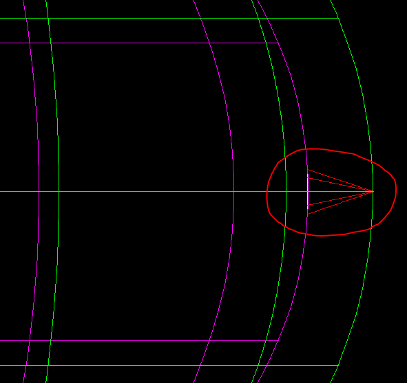

ReMark Posted March 21, 2013 Posted March 21, 2013 See that area I circled in red? That's the concave base of your cone. Quote
