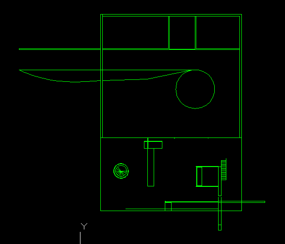

By that I mean that I'm still unsure of what to do next. I stared at my paper for a good 30 minutes and could not figure out what were the next sets of lines that I could add with the given dimensions. So my DWG file is still the same as the one previously posted.
Normally a person would scale a feature such as a line representing a wall off the paper print and then reproduce it in their CAD drawing. To get the line the exact length in the drawing use the direct distance entry method.
Assuming the line is either horizontal or vertical, toggle OrthoMode on (the F8 key), start the Line command, pick your starting point and drag your mouse in the direction you want the line to go in. Type the distance at the command line followed by pressing the Enter key. Use your OSnaps (you do know what they are don't you?) for accuracy when picking starting points of lines that you want to originate at the endpoints of other lines you have already drawn. If it is a wall there will be a line representing the exterior as well as the interior face. Draw one and use the Offset command to create the other. If two lines intersect each other, one perpendicular to the other, and you want to clean up any overhanging pieces use your Trim command or use the Fillet command with a "0.00" radius.

  ReMark said:
[ATTACH=CONFIG]40859[/ATTACH]
I did this last night after your last post.
I use the Line, Circle, Rectangle, Trim and Offset commands.
I also used a Polyline that I did a Fit Curve to via the PEdit command.
Thanks ReMark, this is what I would want ideally to show to my professor. Ok I know that you use the line, circle, rectangle commands but I still have no clue as to what values to use.
The "values" for this drawing came from the PDF you posted. Some dimensions are obviously shown on the PDF while others have to be scaled.
Do you have a metric architectural scale or at least a 1:200 metric scale you can use?
You don't even need a scale, a ruler or tape measure will work. Just measure a known dimension and make a ratio. then multiply ruler dimensions by the ratio to get actual dimensions. So if you measure a wall that is 10' with the tape measure and the tape measure dimension is 1 3/16 inches you have the following ratio: 10ft/1.1875 inches = 8.42ft/inch. The unknown dimension is then measure with the tape measure and say you measure 2 3/4 inches. Just multiply 2 3/4 by 8.42 to obtain the actual measurement.
No I just have an imperial arch scale.. I will just try to get a one on one with the teacher but the outline you did earlier is possible with just the given units?
Do you mind uploading the dwg, I am trying to get it to look nicely but I cannot.
Metric or imperial, it does not matter, the logic is the same. In fact he could use a ruler to measure everything and draw it at the ruler measurements then scale the whole drawing at once by the scale ratio. I think.
Just put the image file into AutoCAD.
Scale it to match the known dimensions.
Start drawing the rest.
Done.
There is no need to interpet a physical scale when you have a digital scale (AutoCAD) that will do it for you.
As I said earlier - I haven't physically scaled a drawing since sometime well into the last century.
Attach your dwg drawn in Meters (like the pdf) and I'll show you how to do the rest.
