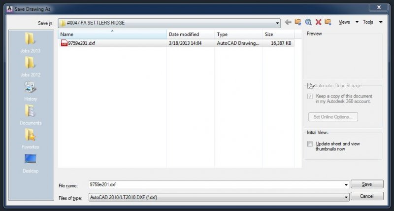

slovenc0417 Posted March 19, 2013 Author Posted March 19, 2013 I am replying to my own post. Apparently by setting FILEDIA to 0 will give me more options in regard to DXFOUT. Can someone please give me an explanation on how these additional steps/parameters can specifically eliminate these nefarious linetypes? Quote

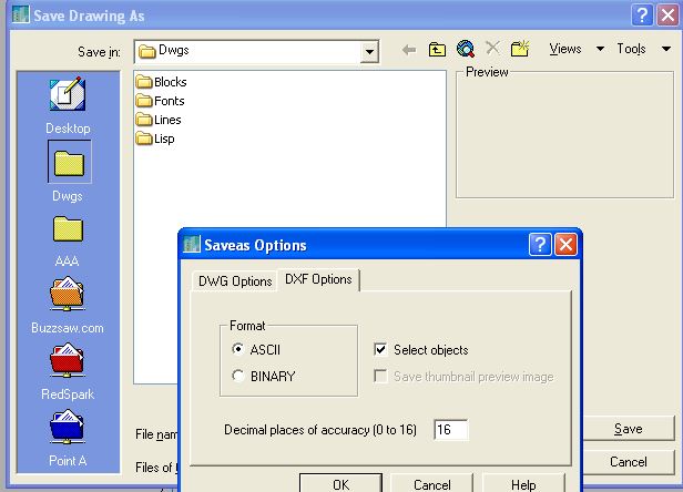

eldon Posted March 19, 2013 Posted March 19, 2013 When I type DXFOUT a SAVE AS window pops up with the FILE TYPE set to "AutoCAD 2010/LT2010 DXF (*.dxf). I do not see an option to Select Objects. What am I missing? At the extreme right hand side of the window is Tools with an arrow pointing down. Click on this arrow, and on the next menu choose Options at the bottom. Now you have a window Saveas Options where you can choose DXF Options. Now you can choose Select objects. Quote

slovenc0417 Posted March 19, 2013 Author Posted March 19, 2013 At the extreme right hand side of the window is Tools with an arrow pointing down. Click on this arrow, and on the next menu choose Options at the bottom. Now you have a window Saveas Options where you can choose DXF Options. Now you can choose Select objects. Before reading forward please understand that I am EXTREMELY grateful for all of your help and assistance!!! Also, keep in mind that the file I sent the other day was only a way of me showing the type of linetypes I am dealing with. Any test that you run on that file is not a true test because it's structure somehow changed when I reduced the size in order to email it. I have placed a file in Dropbox that will give you a true indication of what I am dealing with. https://dl.dropbox.com/u/78846593/Sample_01.dwg Having said all that, I may need a better explanation of what DXFOUT actually does. To me I was simply changing the .dwg into a .dxf format that would allow me to purge these linetypes. The "Select objects" option was not familiar to me and I do not know what that does for me. I did as eldon instructed and it did not remove the linetypes in question. 1. Typed DXFOUT 2. "Save Drawing As" window opens > Tools > Options > DXF Options tab > Selected "Select objects" > OK 3. Save 4. Typed ALL at the "DXFOUT Select objects:" prompt 5. "DXFOUT Select objects:" prompt appears again, hit ENTER 6. Back to command prompt... linetypes still there. Quote
