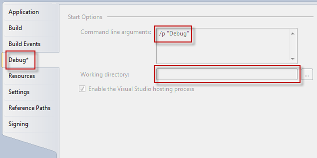

You can debug from Visual Studio, just use a /p "Debug" Profile call (where your Acad.lsp doesn't load) in your Project Properties, Debug tab, Command Line Arguments. :thumbsup:

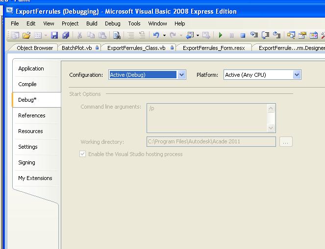

BB, have I done this right? I have added the /p but my acad.lsp still gets called. I am using VS2008 express with ACADE 2011.
Well, let's back up for a moment....
The intent here is to effectively debug your assembly's code in session, using your production environment (or a copy of), which can be done a few different ways.
One common way, so as to not affect one's actual production environment accidentally, is to make a copy of your normal working Profile (for this example, we'll call it "Debug"), where your Visual Studio Project's Properties, Debug tab, Command Line Arguments target this Profile, like so using the /p Startup Switch (see image below, VS 2010 Express C# shown).
** Edit - If you include the Command Line Arguments in a debug session from Visual Studio and have not yet manually created a copy of your working Profile of the same name being targeted, the default Profile settings will be used to create a new Profile named "Debug" just as it would were you to use this Startup Switch from a separate application icon.
Also worthy of note, is that I leave my working folder blank, which effectively loads Drawing1.dwg as my ..\Debug\ folder, which can be useful as discussed below.
Now, this is a copy of your working Profile, so it too will point to your Acad.lsp file to netload your Release assembly (or a copy of that you've placed on the network).
One option here now, use the LOGINNAME System Variable to qualify yourself for this option, then use the vl-File-Systime function to load the newer of the two assemblies found in ..\Release\, or ..\Debug\. This will work, but you still need to write the code for this, and we're still trying to Debug your .NET code.
Another way to go about this, is to place a 'bootstrap' Acad.lsp file in your Debug folder, which will netload that assembly (found in ..\Debug\), as for years AutoCAD has (to my mind) improperly loaded from the Working Folder prior to the SFSP.
Does that make (more?) sense to you now?
