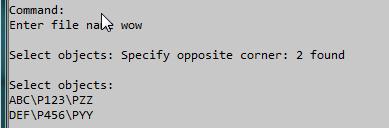

Thanks guys. I changed the directory to "C:Test/" and added a file extension. That then worked :D
Command:
Enter file name test1.csv
Select objects: Specify opposite corner: 2 found
Select objects:
ABC\P123\PZZ
DEF\P456\PYY
Command:

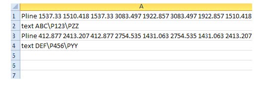

The finish line is in sight. Please see the screen shot attached

Can some help please with a simple mtext to line by line list I am not sure that the abc\\1234\\has more info in it. I am trying to finally fix this up for drafty.

Can somebody help me make change in the code?
I would like each coordinate to be on a separate line and empty row between each polyline.
