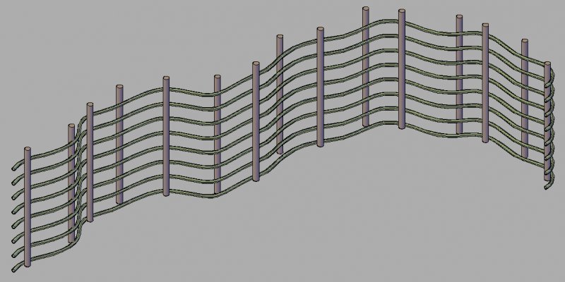

JPR Illustration Posted March 12, 2013 Posted March 12, 2013 Hi all, I am trying to recreate the remains of a viking house that was discovered during excavations in the centre of Dublin. I want to recreate the conditions of the house from when it was found. A part of this would be to create the 'wattled walls. Basically, I am wondering if any of you experts know or have any ideas on how to create this wattling - should I be using the pipe or tube method? If so, is there a quick command for tubes/pipes that weave around each other? I have attached a pdf of the plan of one of these houses. Thanks for your time. Any suggestions welcome! Level 10 Detail-Layout2.pdfFetching info... Quote
ReMark Posted March 12, 2013 Posted March 12, 2013 I suppose you could use a polyline and either curve fit it or spline it then sweep a circle along this "path" to create your wattling. Quote
ReMark Posted March 12, 2013 Posted March 12, 2013 You could start with something similar to this but I can see where you are going to run into some problems as your structure grows in size. Quote

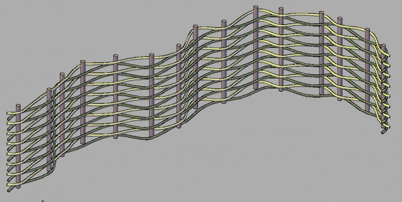

ReMark Posted March 12, 2013 Posted March 12, 2013 A little more weaving has been added. Just doesn't look random enough though does it? Quote
JPR Illustration Posted March 12, 2013 Author Posted March 12, 2013 Hi ReMark, Thanks a million for your responses. More than I would have wished for!! In fairness, that looks great. I am a bit of a novice using AutoCAD, so if you could tell me how you did this I would really appreciate it. Quote
ReMark Posted March 12, 2013 Posted March 12, 2013 I drew a circle. I copied the circle randomly. I used the polyline command, with Orthomode disabled, and randomly drew a series of line segments in and around the circles. Next I used the PEdit command with the Spline option to make the line "snaky". I extruded the circles to simulate posts. I drew a circle and using the Sweep command swept it along the snaky polyline I previously created. I copied this vertically at a set distance. I created a second snaky line and repeated the process. This weave could get tiresome to make. It does not look random enough and I think you'll run into other problems depending on the size and shape of your structure. I think you need to look at a different way of doing this. Quote
