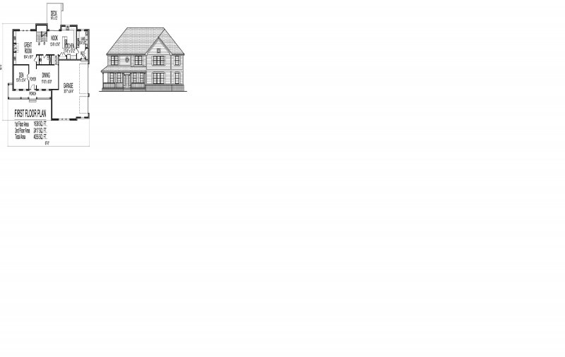

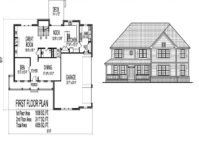

KharizzaJeh Posted March 8, 2013 Posted March 8, 2013 Im trying to draw this floor plan, Actually I don't understand the dimensioning thats why im having a hard time I also want to know how to draw the walls on the plan Can anyone help me Please? Quote
ReMark Posted March 8, 2013 Posted March 8, 2013 Those are rough dimensions. Can you post a larger image of the floor plan? Are you drawing this in metric or imperial units? Quote
ReMark Posted March 8, 2013 Posted March 8, 2013 (edited) Imperial units. OK. Make sure you use the acad.dwt template and set your units to Architectural. The precision can be set to 1/4". Most houses built in the U.S. are done so using 2x4's for the framing although at one time 2x6 framing for the exterior walls was popular. Do you know that a 2x4 actually measures 1 1/2"x3 1/2"? If you use any 1x4's or 1x6's they will be 3/4"x3 1/2" and 3/4"x5 1/2" respectively. Are you familiar with this dimension lumber in terms of what the common sizes used in framing a house are? You should also look at the dimensions for such things as plywood (for roofing and sheathing) and gypsum board (i.e. - sheetrock). Edited March 8, 2013 by ReMark Quote
ReMark Posted March 8, 2013 Posted March 8, 2013 (edited) Note that the wall behind the toilet appears to be thicker. That's to allow for a pipe chase. 2x6 construction would be the norm there. Not sure I agree that placing the toilet on that wall is such a good idea. Typical wall section of an American house framed with 2x4's...http://www.co.delaware.oh.us/codecomp/pdf/infopacks/homes/typical%20wall%20section%202.pdf I'd use nothing less than 7/16" (range 5/16" to 3/4") sheathing on the exterior and 1/2" gypsum board on the interior. An example of what a city or town might specify as being an acceptable set of plans for a house....http://www.co.whatcom.wa.us/pds/build/accessory/plans/pdf/BuildingPlansrequirements.pdf I suggest that perhaps for your first house you start off with a single story ranch style (basically it's a rectangle). Do the foundation plan, floor plan, the four elevations and include a typical wall section. I would suggest a simple gable end roof as well. After doing that then you can tackle a multi-story house with stairways and porches/decks, garage, and a more challenging roof. Edited March 8, 2013 by ReMark Quote

Ski_Me Posted March 8, 2013 Posted March 8, 2013 I think he just wants to draw the floor plan not the whole house. The dimensions you see are from inside to inside. So layout your first wall starting from the most inside and central wall you can find then offset to the inside of the closest exterior wall. Try to work your way out from the inside. Won't be able to be dead on with the plan cause you don't have all the information but you should be close. Remember when you offset for you walls figure 3-1/2" for the stud and 1-1/4" (5/8 x 2 typical for residential) for the drywall in your interior walls. Same thing for the exterior wall but add for the brick (can't remember what the dimension for brick is) and 1/2" between the brick and vapor barrier. It's not hard but you need to pay attention to the details to get it close. You can figure out the windows and doors yourself. Quote
welldriller Posted March 9, 2013 Posted March 9, 2013 WOW --- Got to get my glasses changed. Looks like feet and inches to me on the drawing. Quote
ReMark Posted March 9, 2013 Posted March 9, 2013 Yes, it is feet and inches. I could not tell for sure by looking at the first posted image. Quote
Dana W Posted March 9, 2013 Posted March 9, 2013 That is a real estate sales office floor plan. The dimensions are rounded up a bit and probably only hint at the widest/longest distances in each room. They are merely for the prospective buyer to have a general idea of the room sizes. You could use that plan as a general guide only, to lay out the overall plan. Quote
KharizzaJeh Posted March 9, 2013 Author Posted March 9, 2013 should the drawing units be in inches? and about the walls, how will i make the thick lines, Quote
