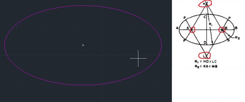

Mena__99 Posted March 7, 2013 Posted March 7, 2013 Hi , i have small problem but its really important for my collage drawing i have drawing an ellipse using the ellipse drawing command and now i need to figure out the 4 points that draw this ellipse Points (H,K,M,L) .. how i can draw the 4 points on autocad ? .. i only know the center and both the majority and minority diameter "sounds enough to me but i dont know how to do it on autocad (( i have version 2013 )) " Quote
ReMark Posted March 7, 2013 Posted March 7, 2013 (edited) I only vaguely remember two methods of doing this and they date back to my manual drafting days where ellipses were not as exact as a CAD program will draw them today. The methods were called the four-centered ellipse and the eight-centered ellipse. The second method was said to yield a better (truer?) result. Your little diagram to the right appears to depict the four-centered method. You should be able to find an explanation of the technique in any technical drafting book or online for that matter. How exact do you have to be? Check out this link. You'll have to scroll down slightly to where two methods (five-center and four-center) are depicted. Click on an image to see an enlarged view. http://etc.usf.edu/clipart/galleries/455-geometric-constructions Edited March 7, 2013 by ReMark Quote

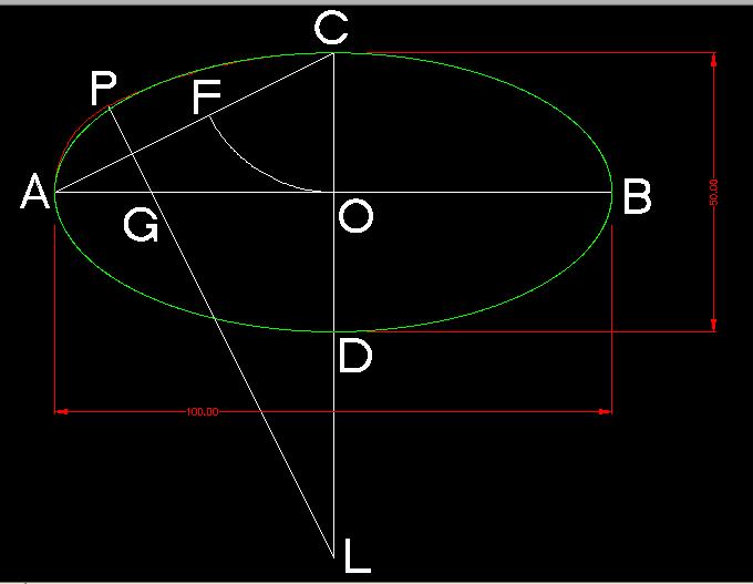

JD Mather Posted March 7, 2013 Posted March 7, 2013 Attach your dwg file here. As indicated by ReMark, the method you depict creates 4 arcs that were blended with a pencil. It is not a true mathematical ellipse and I can show you how to graphically/geometrically demonstrate this to your professor if you attach your dwg file here. Quote

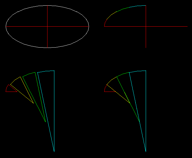

ReMark Posted March 7, 2013 Posted March 7, 2013 (edited) I have a question... As the ellipse behinds to flatten (the height gets less) would an eight-centered approximation really be close? ...and an observation. From my very unscientific method for determining how AutoCAD constructs an ellipse (pellipse=1) I drew an ellipse and then exploded it. It appears each quadrant of the ellipse is comprised of four different arcs. Edited March 7, 2013 by ReMark Quote
JD Mather Posted March 7, 2013 Posted March 7, 2013 Mena__99 said: ... .. i only know the center and both the majority and minority diameter "sounds enough to me... I found several websites that show how to do it, but at least one I found on YouTube shows a wayyyy to complex technique. I thought I would be able to show you a technique in AutoCAD using Parameters, but found AutoCAD wayyyy to clunky and ended up doing it in Inventor. Quote
neophoible Posted March 7, 2013 Posted March 7, 2013 ReMark said: I have a question... As the ellipse behinds to flatten (the height gets less) would an eight-centered approximation really be close? ...and an observation. From my very unscientific method for determining how AutoCAD constructs an ellipse (pellipse=1) I drew an ellipse and then exploded it. It appears each quadrant of the ellipse is comprised of four different arcs. Did you try overlaying with an ellipse of the same-parameters made when pellipse=0? From JD's post, it looks like the 4-point is much better than a stopped watch telling time anyways. Quote

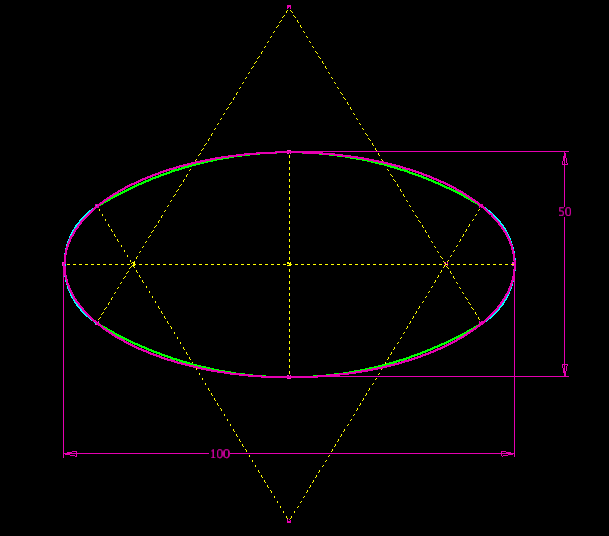

neophoible Posted March 11, 2013 Posted March 11, 2013 I agree that a 4-pt method, etc, will not draw a true ellipse, but I’m not so sure it’s meant to be a trick question. It’s interesting to see how close the approximation comes. Did anyone else try it out besides JD? I got around to actually trying ReMark’s interesting link, but my attempt at following the solution (see below) did not match JD’s. I’m wondering why. JD does not seem to show how he got the centers, at least as far as I can tell, but his approximation looks more even. I’m not absolutely sure I followed directions correctly in my attempt. I think they were worded confusingly. Like ReMark, I very vaguely remember using such an approximation long ago--in high school--so I'm not sure it's the same one. Quote
eldon Posted March 11, 2013 Posted March 11, 2013 Since the OP stated that the ellipse was drawn with the Ellipse command, then the points H, K, M and L would not exist as they are only involved with drawing an approximate ellipse with arcs. If the OP were to have constructed the approximate ellipse in the first place using arcs, then these points would already exist. So the OP's request to find these points was a non sequiter, because those points are not involved in the drawing of a true ellipse. Quote

ReMark Posted March 12, 2013 Posted March 12, 2013 If an ellipse cannot be defined by an arc then what do you make of the way AutoCAD constructs one? I believe there are 11 dimensions. Quote

neophoible Posted March 12, 2013 Posted March 12, 2013 ReMark said: If an ellipse cannot be defined by an arc then what do you make of the way AutoCAD constructs one? Well, I’m thinking that your exploded image of an AutoCAD ellipse created when PELLIPSE=1 looks like a very good 12-ctr approximation. It may be way over my head to understand how they generate what is essentially a true ellipse (like what Eldon is talking about) when PELLIPSE=0, but I'm guessing that the mathematical error is essentially negligible, that is, akin to circles, etc. I did compare the two variations and they are pretty close using JD’s dims of 100 & 50, but they do not look exactly the same. Of course, if memory serves me here, AutoCAD hasn’t always had the true ellipse option. ReMark said: I believe there are 11 dimensions. Yes, I’ve heard from men I respect that there must be at least that many spatial-temporal dimensions just to have what we notice daily. Of course it doesn’t mean that that’s the limit, nor does it mean we have direct access to those beyond the basic 4, or, as I called them, 3-1/2, and that was because traveling back in time is still fantasy and has no humanly foreseeable future. I can still have fun watching sci-fi stuff that includes it, though. Quote
