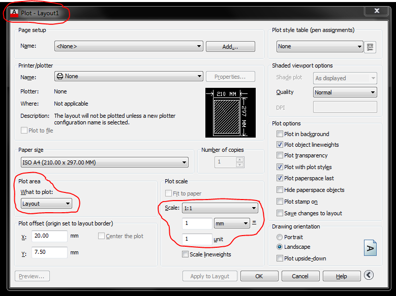

raley123 Posted March 6, 2013 Posted March 6, 2013 Hi, I am relatively new to CAD and trying to help my partner with electrical and mechanical drawings. I am working from a drawing in model space (previously drawn by a client) and I have imported it into model space, working in 1:1. I am now trying to view my work in paper space - the problem i am having is that i now need to scale this drawing. Most of the scales i will be working with are either A1 1:50 or A3 1:100. I have read some previous posts and can see that i need to be amending the page setup on the layout tabs - if i select paper A1 and customise the scale to 0.02 (1:50), will that then automatically scale any viewport I insert into that layout? Or do I need to still scale the viewport (as well as the page setup) that I insert and if so....can anyone assist with this and how to scale it so that the viewport doesnt look minute or massive? I hope this makes sense! Thanks! Quote
ReMark Posted March 6, 2013 Posted March 6, 2013 The viewport needs to have a scale assigned to it. There are several ways to do this. How many of them do you know? When it comes time to plot do so at a 1:1 scale since you will be plotting from a paper space layout. Almost everything you need to know about viewports can be found in this write up... http://www.cadtutor.net/forum/showthread.php?72972-Things-you-should-know-about-Viewports.&highlight=viewports Quote

raley123 Posted March 6, 2013 Author Posted March 6, 2013 from your screen shot, if I amended the paper to A1, do i still plot it to 1:1 and layout? sorry for all questions! Quote
ReMark Posted March 6, 2013 Posted March 6, 2013 You do not set a scale other than 1:1 in the page setup of your layout (see my previous post with image). If the scale you assigned to the viewport made the model space objects appear very, very small then you obviously used the wrong scale. You should have then tried a different scale. For example, instead of using a scale of 1:200 you should have used a scale of 1:50. Quote

ReMark Posted March 6, 2013 Posted March 6, 2013 from your screen shot, if I amended the paper to A1, do i still plot it to 1:1 and layout? sorry for all questions! Yes. I hate to ask but did you make sure to use a metric template for your drawing? Quote
