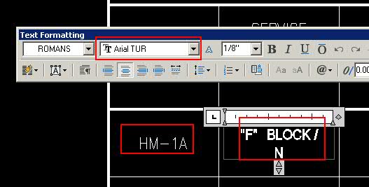

Still there are some texts with difrent style in same table. simple match properties comand not work on these. So problem still here, txt size change but style still same. :facepalm:
If you have a look-see on my first post. i also included the option to change the textstyle.
