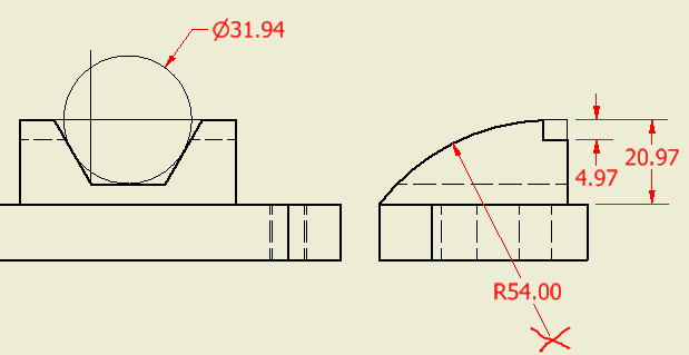

Sir, is my drawing correct?

You started from the wrong template and your part is too big.
You will need to scale the part, but
the part is also incorrect.
The center of the R54 is in wrong location.

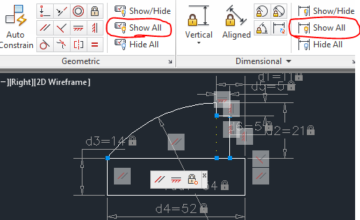

I recommend that you start learning Parametric constraints - a bit clunky in AutoCAD (compared to a modern program like Autodesk Inventor), but will help solve geometry problems like this with more certainty.
(see attached file)
Locating Finger.dwg
I thought these would automatically be visable, you will have to Show All on the Parameters tab.
Not that you really need parametric geometry constraints.
A trick to and an unknown centerpoint is to draw circle with center at point each point where your desired arc will end (with the desired radius). Where these two circles intersect will be the location of the center of your desired arc (there will actually be two intersections - but it will be obvious which one to use).
