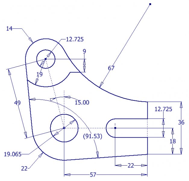

KharizzaJeh Posted March 5, 2013 Author Posted March 5, 2013 Sir JD Mather, is the back of the figure inclined by 15 deg.? Quote
KharizzaJeh Posted March 5, 2013 Author Posted March 5, 2013 Thanks to all of you! I completed the drawing and it looks exactly as the figure Thankyou! Quote

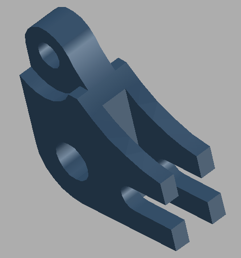

ReMark Posted March 5, 2013 Posted March 5, 2013 The reason there was a line was twofold. I had not unioned the parts of the object and I used a Conceptual visual style. Here it is after doing a union and in Realistic visual style. It has also been rotated 15 degrees. Glad to hear you got it all worked out. Quote

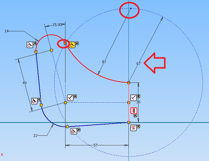

JD Mather Posted March 5, 2013 Posted March 5, 2013 Oh ye of little faith. This is from Giesecke, et al Technical Drawing, the textbook I use. Ye of much experience! I will believe when I measure. Parametric solution. Note that the baseline is not parallel to the 57 dimension. Note that the baseline is not horizontal or perpendicular to right vertical line. Note the 91.53° reference angle (in other words - not perpendicular to the baseline). Quote

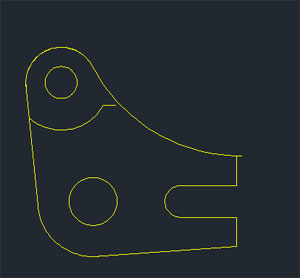

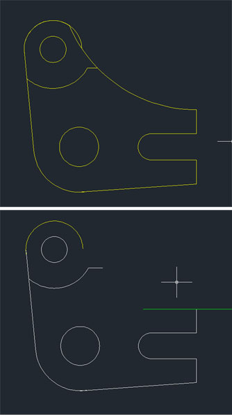

97catintenn Posted March 5, 2013 Posted March 5, 2013 You asked, 'where do i put r67?' I thought the same thing, so I started with it. Then drew a line straight down, and finished the drawing. But r67 wasn't tanget to r14, so then I erased r67 and drew it tangent r14 and a line perpendicular to line36. Quote
JD Mather Posted March 5, 2013 Posted March 5, 2013 (edited) ... a line perpendicular to line36. And what does that give you? Post screen shot. Johnson City huh. ETSU? Do you know Keith Johnson? Drawing a construction circle at the end of 36 we know that the center of the desired arc is somewhere on the construction circle (note visually that it is not straight up from the vertical 36. It looks in this image like the tangent point is straight up vertically from the left hole and on the construction circle, but If I showed an image zoomed in - it is not. Edited March 5, 2013 by JD Mather Quote
97catintenn Posted March 5, 2013 Posted March 5, 2013 The yellow image is as far as got with starting with the circle r67. So I deleted it and redrew the arc (circle). This moved the center cirlce r67, so that it is NOT in line with line36. I didn't catch that before, but I think it is correct. Quote
97catintenn Posted March 5, 2013 Posted March 5, 2013 Ahh, nevermind. I see that my method does not work. it appears line 36 is touching the arc, but it isn't and that's why my trim command wouldn't trim the arc back. I should've went to ETSU! Quote

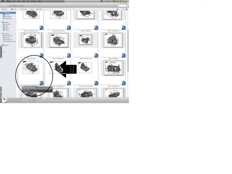

KharizzaJeh Posted March 6, 2013 Author Posted March 6, 2013 Im not sure if my output is correct, please help me check the errors Figure 7.67 Locating Finger.dwg Figure 7.68 Toggle Lever.dwg Quote
KharizzaJeh Posted March 6, 2013 Author Posted March 6, 2013 another problem occur, in the figure 7.67 that i attached, the figure doesnt show up on the workspace, i dont know if there is a problem in the drawing or I just mistakenly erased the figure and left only the dimensions..... but as far as i remember i havent erase the figure maybe there is a solution for the figure to show up again on the workspace? Quote
ReMark Posted March 6, 2013 Posted March 6, 2013 The only objects in the Figure 7.67 drawing are your dimensions. Quote
JD Mather Posted March 6, 2013 Posted March 6, 2013 Fig 7.86 is not correct per evidence presented earlier in this thread. I will post correct geometry in a while. Give it another shot while I eat breakfast. As far as your missing geometry - I have been hearing an alarming number of similar reports. Try setting solidhist to 0 for all future work. Quote
KharizzaJeh Posted March 6, 2013 Author Posted March 6, 2013 the workspace only shows the dimensions, but when I view the DWG file on its folder/rootfolder the figure was shown as its Icon... how can that happen, i cant view the figure on the workspace only the dimensions appear Quote
KharizzaJeh Posted March 6, 2013 Author Posted March 6, 2013 but the icon shows the preview of the drawing right? Quote
ReMark Posted March 6, 2013 Posted March 6, 2013 You're wasting your time. You inadvertently erased a portion of your drawing and then saved it. Start over. Your only hope is that somewhere on your hard drive you have a BAK file that retained the 3D solid. Look for the file. If you find it rename it as a DWG file and open it. Maybe you'll get lucky. Quote
