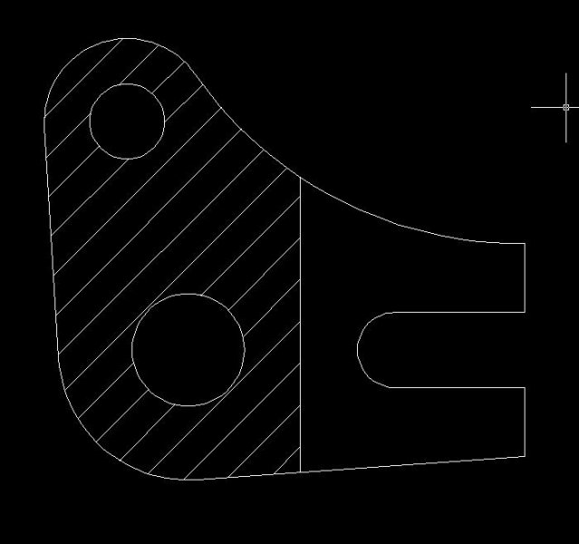

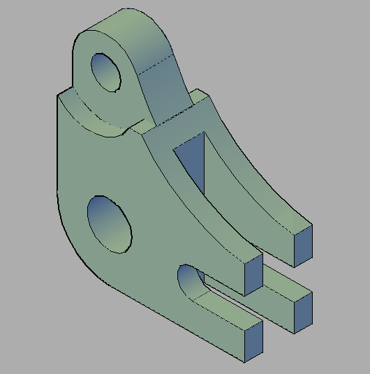

KharizzaJeh Posted March 5, 2013 Posted March 5, 2013 I have a problem drawing this two figures, it seems that it doesnt have the complete dimensions... can anyone help me draw this or teach me instead..? Quote
ReMark Posted March 5, 2013 Posted March 5, 2013 Is this a class assignment? Are you drawing the isometric view only or do you have to draw all the standard views (top, front, and side)? Quote
KharizzaJeh Posted March 5, 2013 Author Posted March 5, 2013 yes, we are assigned to draw it in 3d... Quote
KharizzaJeh Posted March 5, 2013 Author Posted March 5, 2013 i already drawn figure 7.67, but im not sure if i drew it right Quote
ReMark Posted March 5, 2013 Posted March 5, 2013 Attach a copy of the DWG file to your next post and someone here will take a look at it. Quote
KharizzaJeh Posted March 5, 2013 Author Posted March 5, 2013 figure 7.67, i havent drawn 7.68 Drawing3.dwgFetching info... Quote
ReMark Posted March 5, 2013 Posted March 5, 2013 At first glance your drawing looks pretty good but there are a couple of things I need to check. Of the four holes that penetrate the base two are supposed to have a 9mm diameter and the other two a 8mm diameter. You have one hole at 9mm and the other three at 8mm. Quote
KharizzaJeh Posted March 5, 2013 Author Posted March 5, 2013 thank you very much, please do check the errors, thank you Sir Quote
ReMark Posted March 5, 2013 Posted March 5, 2013 Figure 7.68 is a bit unusual. I'll have to study it further. Quote
KharizzaJeh Posted March 5, 2013 Author Posted March 5, 2013 thanks again, I'm really having a hardtime in that figure Quote
KharizzaJeh Posted March 5, 2013 Author Posted March 5, 2013 I really need your help in that figure, Quote
dbroada Posted March 5, 2013 Posted March 5, 2013 I think there is enough information there but you will need to use the TANGENT snap. (I only do 2D so I may have missed something in the other view). Quote
KharizzaJeh Posted March 5, 2013 Author Posted March 5, 2013 i also tried doing the 2d, but i cant figure out where will i Find the dimensions of the upper left side of the figure Quote
dbroada Posted March 5, 2013 Posted March 5, 2013 ReMark and I have interrpreted it slightly differently (I think he is more correct than me) in where we have positioed the large curve. As for the left side, you can position both holes wrt each other which gives you the outside shape. Start by putting the holes down. Quote
KharizzaJeh Posted March 5, 2013 Author Posted March 5, 2013 that looks great I still cant figure out where will i put the center R67 Quote
dbroada Posted March 5, 2013 Posted March 5, 2013 that is where ReMark and I differ. I now think it is in line with the RH edge. Quote
JD Mather Posted March 5, 2013 Posted March 5, 2013 Tangent to R14 and passing through 36. If you use Constraints (parametric tab) this will be solved for you. I don't think there is a planar face between the two. (therefore no line) Back in a bit to check it closer. Quote
