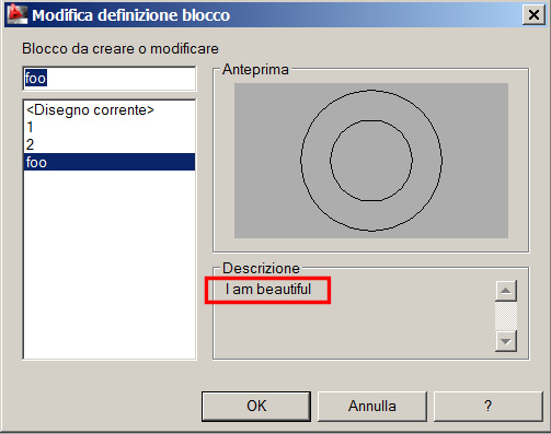

If I insert the block into a new dwg with INSERT (dialog box), there exists the comment/description:

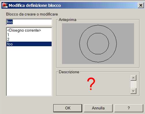

If I insert the block with -INSERT or with lisp (command "insert" "D:/CADTutor/foo.dwg") there is no comment/description:
Any suggestions?
