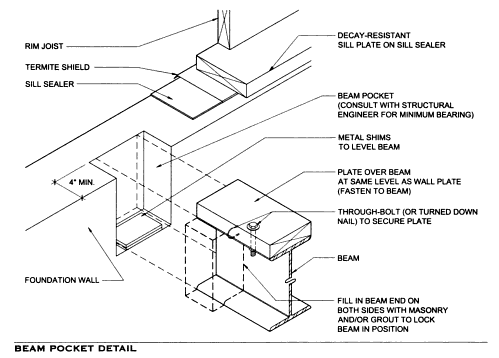

I am looking to find a sample drawing of how an I beam would connect to a masonry wall, I'm not sure how much detail to add.
Does anyone know where to find sample drawings like this?
Is the beam going to sit perpendicular to the wall in a pocket?
We need a better idea of what you are attempting to do.
Hi mark. Yes it is normal to the adjoining masonry wall inside a pocket
Is there steel decking sitting atop the beam?
Is this for a residence?
Beam Pocket Detail
I did not draw this.
Source: Architectural Graphic Standards for Residential Construction.
ReMark, that is exactly what I was looking for, thank you
I would think there will be building standards for your part of the word, here in New Zealand with our eathquakes it may be different. Contact your building authorities first, or a sturctual engineer
