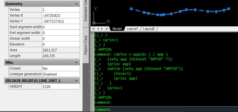

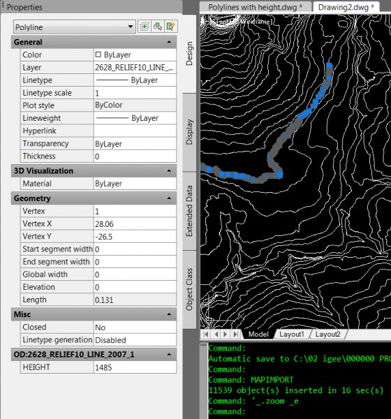

Jozi68 Posted February 22, 2013 Share Posted February 22, 2013 I have a drawing with thousands of Polylines. They all have a "Height" property (that i've added with some import command a while ago). Now I need a small procedure to take the value in the "Height" property, and put it in the "Elevation" property. I have no idea where to start. Quote Link to comment Share on other sites More sharing options...

Jozi68 Posted February 22, 2013 Author Share Posted February 22, 2013 MAPIMPORT Select a shp file Click the speedbutton in the Data column Click "Create object data" Click select Fields... Uncheck all except "Height" click OK click OK The result: Thousands of polylines, each with a height property. NOW, how do I get the value of the height property into the elevation property? Quote Link to comment Share on other sites More sharing options...

marko_ribar Posted February 24, 2013 Share Posted February 24, 2013 As I can see, there are no registered app "HEIGHT" to this entity... Still, try to check for all registered APPIDS in your DWG, so execute this code and copy+paste here results : (defun c:appids ( / app ) (setq app (tblnext "APPID" T)) (princ app) (while (setq app (tblnext "APPID")) (terpri) (princ app) ) (princ) ) Quote Link to comment Share on other sites More sharing options...
Jozi68 Posted February 24, 2013 Author Share Posted February 24, 2013 Hi Marko, I ran this but get no results. Maybe I'm doing it wrong. Quote Link to comment Share on other sites More sharing options...
marko_ribar Posted February 24, 2013 Share Posted February 24, 2013 After you load it with as you did copying+pasting code to CAD's interface, or saving code as *.lsp file and load it with APPLOAD, you'll notice that last prompt as shown in your picture is prompt C:APPIDS... This means that code was loaded into memory as C: (command function)... You'll have to type at prompt Command: APPIDS and hit ENTER... Then, your text screen (this what you showed with picture) will show info witch I want you to copy+paste here, like you did earlier in your replies... Quote Link to comment Share on other sites More sharing options...
Jozi68 Posted February 25, 2013 Author Share Posted February 25, 2013 Got it. Here are my results: Command: APPIDS ((0 . APPID) (2 . ACAD) (70 . 0)) ((0 . APPID) (2 . ACAD_PSEXT) (70 . 0)) ((0 . APPID) (2 . AcadAnnoPO) (70 . 0)) ((0 . APPID) (2 . AcadAnnotative) (70 . 0)) ((0 . APPID) (2 . ACAD_DSTYLE_DIMJAG) (70 . 0)) ((0 . APPID) (2 . ACAD_DSTYLE_DIMTALN) (70 . 0)) ((0 . APPID) (2 . ACAD_MLEADERVER) (70 . 0)) ((0 . APPID) (2 . ACAD_EXEMPT_FROM_CAD_STANDARDS) (70 . 0)) ((0 . APPID) (2 . AcMapDMDisplayStyleRegapp) (70 . 0)) ((0 . APPID) (2 . AeccLand70) (70 . 0)) ((0 . APPID) (2 . AeccUiQTO) (70 . 0)) ((0 . APPID) (2 . AeccUiQTOEntityPayItemData) (70 . 0)) ((0 . APPID) (2 . AeccUiQTOPayItemFilePath) (70 . 0)) ((0 . APPID) (2 . AeccUiQTOPayItemCategoryFilePath) (70 . 0)) ((0 . APPID) (2 . AeccUiQTOFreqUsedPayItemsList) (70 . 0)) ((0 . APPID) (2 . AeccUiQTOPayItemFormulaFilePath) (70 . 0)) ((0 . APPID) (2 . AeccUiQTOPayItemSpecBookVersionFloridaDOT) (70 . 0)) ((0 . APPID) (2 . AeccUiQTOPayItemFormulaParameters) (70 . 0)) ((0 . APPID) (2 . AeccUiQTOPayItemFormulaExpression) (70 . 0)) ((0 . APPID) (2 . AeccUiQTOTransportDesignerFileFloridaDOT) (70 . 0)) ((0 . APPID) (2 . AeccUiModel) (70 . 0)) ((0 . APPID) (2 . ADE) (70 . 0)) ((0 . APPID) (2 . MapGWS) (70 . 0)) ((0 . APPID) (2 . DCO15) (70 . 0)) ((0 . APPID) (2 . AcAecLayerStandard) (70 . 0)) ((0 . APPID) (2 . AcDbBlockRepETag) (70 . 0)) ((0 . APPID) (2 . AcDbDynamicBlockGUID) (70 . 0)) ((0 . APPID) (2 . ACAUTHENVIRON) (70 . 0)) ((0 . APPID) (2 . AcDbDynamicBlockTrueName) (70 . 0)) ((0 . APPID) (2 . AeccLand80) (70 . 0)) ((0 . APPID) (2 . AeccUiMgr) (70 . 0)) ((0 . APPID) (2 . AeccLand90) (70 . 0)) ((0 . APPID) (2 . ACAD_NAV_VCDISPLAY) (70 . 0)) ((0 . APPID) (2 . AcMap_E615D161-C9D7-11d3-839F-0060B0FB6B57) (70 . 0)) ((0 . APPID) (2 . IRD) (70 . 0)) ((0 . APPID) (2 . ADE_PROJECTION) (70 . 0)) ((0 . APPID) (2 . AcPublishKml) (70 . 0)) ((0 . APPID) (2 . AcCmTransparency) (70 . 0)) Quote Link to comment Share on other sites More sharing options...
