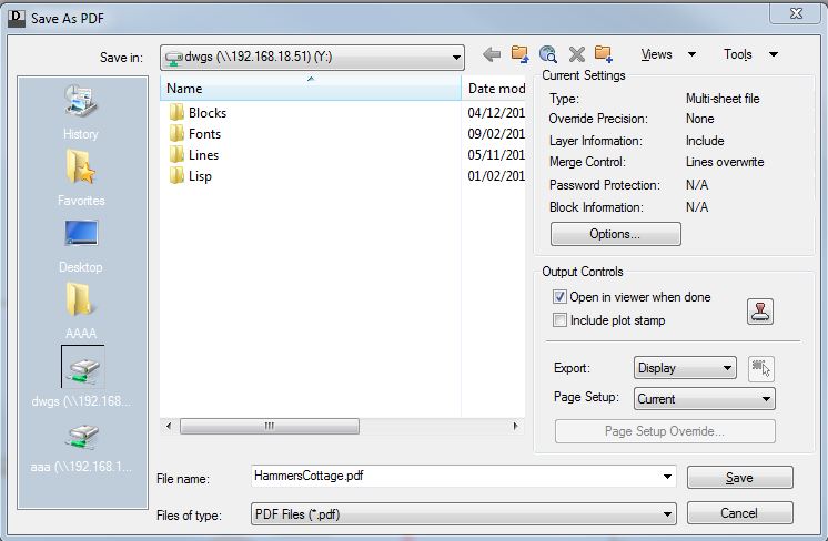

Deltona Posted February 17, 2014 Posted February 17, 2014 The Export command is accessible through the drop-down menu you get when you click the big blue D in the upper left corner of the screen ... Quote
Deltona Posted February 17, 2014 Posted February 17, 2014 Jodym, I feel your pain. We've struggled with this as well. We can't use PLOT at all the way Eldon can ... no matter how many times we sent out PLOT settings to print a monochrome (i.e., blakc and white) PDF, we end up with a color one. It's as if the sytem ignores the settings we put in. We have had success with the EXPORT to PDF function, however. When you choose EXPORT and then choose PDF, it opens up a traditional Save as PDF dialog box which allows two things. First, it allows you to set options for Export and Page Setup. Second, it allows you to dictate where you want the resulting PDF file to be located, just as my normal Adobe Acrobat allows. I have a step-by-step cheat sheet we use here and would be glad to email it to you ... just need to know where. Quote

Jodym Posted February 18, 2014 Author Posted February 18, 2014 Deltona-- Thanks for your response. I tried using the Export function and I specified a path to save the file. I also found a way to specify using the color 'black'; for all colors used in the CAD file, so I was hoping to be able to get a black PDF of my plan. However, when I pressed "Save" I still couldn't find the file. I looked in the folder where I specified the path and then I even searched my entire Documents folder for the file name. No luck. The new PDF file does not exists. I can't imagine what I'm doing wrong. Could you please send your step-by-step cheat sheet to jodymorse@comcast.net? Thanks! Jodym, I feel your pain. We've struggled with this as well. We can't use PLOT at all the way Eldon can ... no matter how many times we sent out PLOT settings to print a monochrome (i.e., blakc and white) PDF, we end up with a color one. It's as if the sytem ignores the settings we put in. We have had success with the EXPORT to PDF function, however. When you choose EXPORT and then choose PDF, it opens up a traditional Save as PDF dialog box which allows two things. First, it allows you to set options for Export and Page Setup. Second, it allows you to dictate where you want the resulting PDF file to be located, just as my normal Adobe Acrobat allows. I have a step-by-step cheat sheet we use here and would be glad to email it to you ... just need to know where. Quote

Jodym Posted March 23, 2016 Author Posted March 23, 2016 It's hard to believe that it's been two years since I posted to this forum. I have yet to figure out how to print anything from DWG Viewer or to save anything to a PDF file. I tried again this morning and found these old forum postings. In reviewing Eldon's advice above, I realized that the screen shot he showed was Plot-Model. I had been trying to Export or Plot - Layout. So, I tried to go to the Model tab and then chose Plot. Then I realized that I don't have any PC3 files or PC3 printers defined. I just have my laser printer that is attached to my PC. Is that my problem? Do I have to have a special Plotter set up? And maybe that's why I can't export to PDF and save it to my hard drive (the pdf file is no where to be found, after I 'save' it on DWG Viewer). I am trying one more time to get advice from this forum. Is there a simple way to print a layout or to export to PDF, so I can print a layout? Quote
eldon Posted March 23, 2016 Posted March 23, 2016 ....So, I tried to go to the Model tab and then chose Plot. Then I realized that I don't have any PC3 files or PC3 printers defined. I just have my laser printer that is attached to my PC. Is that my problem? These are the default plotters when I installed up my DWG TrueView 2013, as seen in the Plotter Manager. Your setup is perhaps lacking??? Quote
Jodym Posted March 23, 2016 Author Posted March 23, 2016 Thanks, Eldon. I DO have those, but never scrolled down to see them. Now I just used the Plot feature again and chose the DWG to PDF pc3 file. I set all the other settings to exactly mirror what you showed in your post a couple of years ago. The file DID save this time as a PDF, so I'm getting closer. Unfortunately the file was 1K and completely blank. I used the drop down choice of "Limits" and set the Plot Offsets to exactly what you had. Any ideas of what I can do to make this work. I'm thinking that maybe I need to use a simpler DWG reader/printer product. I really just want to be able to print DWG files that my architect provides to me. Or convert them to PDF files that anyone can view/print. Quote
eldon Posted March 23, 2016 Posted March 23, 2016 I usually plot a Window. I had not altered the Plot Area in those previous pictures. When you scroll to Window, you then can pick the window to plot which encompasses the required detail. It needs a bit more thought to get it to plot exactly to a required scale, but it is possible without going to a Layout in Paper Space. I have been doing this way for 20+ years, so it is all a bit automatic for me, and I may leave out some necessary details. If in doubt, please ask more. Quote
