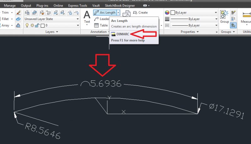

welldriller Posted February 27, 2013 Share Posted February 27, 2013 Click on DIMENSION choose from the drop down menu RADIUS or DIAMETER Pick the end points of the arc Right click your mouse or press enter to complete the dimension the same way as you complete any otherdimension.dwg dimension Quote Link to comment Share on other sites More sharing options...
JD Mather Posted February 27, 2013 Share Posted February 27, 2013 Click on DIMENSION choose from the drop down menu RADIUS or DIAMETER From all the responses I think the question was about arc Length, not radius or diameter. Considering the last response (prior to yours) was several days ago - I think the problem has been solved. Quote Link to comment Share on other sites More sharing options...
