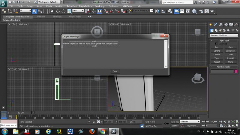

Mena__99 Posted February 15, 2013 Posted February 15, 2013 hii elllo , i got so many help from this forum and i really appraciate every single time u guys saved my ass out there. again iam still on my barely first job text (( working for free to prove myself online )) and i cant prove myself .. i am really in neeed of help :( .. if i failed to do great job i will get a bad feedback again and no one will hire me :( , u have no idea how many time i tried to get a job ... the problem is .. i have a product that iam suppose to model and rendeer i normally use Autocad in 2d , 3d ( modeling ) & rendeering.. since autocad render is not good enough so iam suppose to import it into Lumion3d to give it a realistic look (( so easy to use .. like 2 clicks )) .. the problem is when i import it into the program ... it was there without any rendering data ... i double checked many time that everything is ok on autocad and its ok , everything is correct. i ask before and a guy sugguests that i install 3d max ((i hav 2013 )) import it into 3dmax then export it in 3ds .. which is supported in lumion3d as well so i imported it to 3dmax and i can see the materials ((great! )) when i export it to 3ds .. i got some error i cant fix because i have no idea what causes it and how to fix it :/ Error: ((too many faces to export)) what is that ?? how to fix it ?? .. plz let me know as soon as passable i really need to fix that now ! .. i am suppose to finish this job like 3 days ago :/ Quote

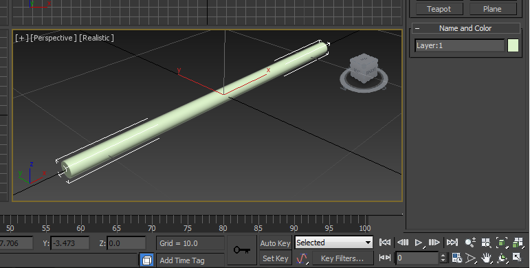

Mena__99 Posted February 15, 2013 Author Posted February 15, 2013 iam an architecture but the only chance i had is to be a modeler of small product that i failed to finish :/ here is screenshoot Quote

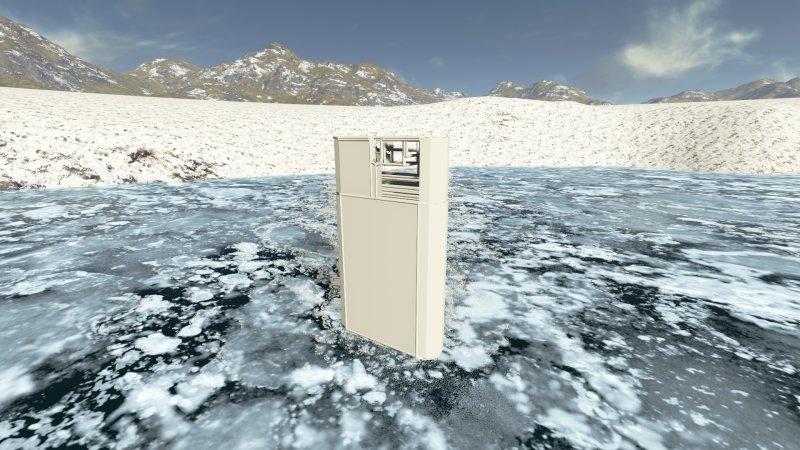

Mena__99 Posted February 15, 2013 Author Posted February 15, 2013 i forgot to say that the project came out again without any rendering .. 3D models: DAE, FBX, MAX, 3DS, OBJ, DWG, DXF i have imported them to 3dmax , sketchup , lumion .. all reacats same way .. no render rmaterials data Quote
SEANT Posted February 15, 2013 Posted February 15, 2013 The 3ds file format has a limitation on the number of faces per object. http://usa.autodesk.com/adsk/servlet/ps/dl/item?siteID=123112&id=5582236&linkID=9241177 Quote
Mena__99 Posted February 15, 2013 Author Posted February 15, 2013 SEANT said: The 3ds file format has a limitation on the number of faces per object.http://usa.autodesk.com/adsk/servlet/ps/dl/item?siteID=123112&id=5582236&linkID=9241177 not working :/ all i get from the whole model is this tube :/ Quote

SEANT Posted February 15, 2013 Posted February 15, 2013 Based on that face limitation, and the error message, it is possible that the objects you are trying to export as a 3ds file are too complex. Perhaps you could try to export one object at a time. If one fails then perhaps apply an “Optimize Modifier”. I don’t use 3DS Max much these days – that is about the extent of advice I’m able to give. Quote

Mena__99 Posted February 15, 2013 Author Posted February 15, 2013 SEANT said: Based on that face limitation, and the error message, it is possible that the objects you are trying to export as a 3ds file are too complex. Perhaps you could try to export one object at a time. If one fails then perhaps apply an “Optimize Modifier”. I don’t use 3DS Max much these days – that is about the extent of advice I’m able to give. thanks alot of the advice , i used the pro optimize modifier , i even lowerd the vertices to 1% ,,, and exported it .. it came out without error but steel no material details :/ Quote

Mena__99 Posted February 15, 2013 Author Posted February 15, 2013 ok this is how it looks after merge :/ Quote
