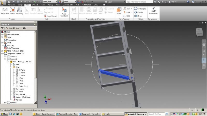

Hey guys,

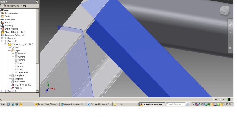

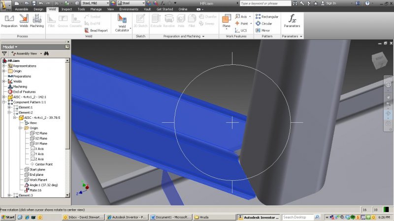

Fairly new to inventor but think I am picking it up well, especially for the little time I have had with the program. So attached are three images of what I have been working on. Basically I have HSS4x4x1/2 sections welded to the web of a C8x11.5. I had no problem coping the HSS4x4x1/2’s so they meet flush with the channel. My question is what is the best way to cope the angle going diagonally? For the HSS I used a plane with the dimensions projected from the end of the channel, then extruded across the HSS member. I hope the included screen shots can help everyone understand what I am looking at a little better.

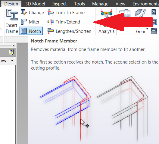

No I am not using Frame generator. Just checked it out and it makes things a whole lot easier! Thanks for the tip!
