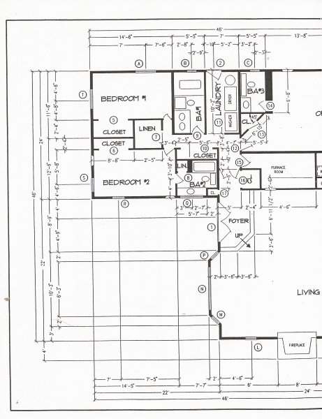

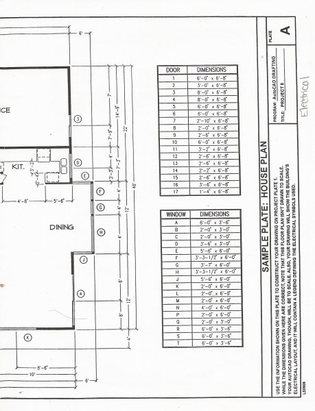

Praxus Posted February 12, 2013 Share Posted February 12, 2013 I recently made a move, and I lost some materials. My due date is swiftly encroaching, anyone available to shoot me a PDF/scan of PLATE A for the home layout, and or a .DWG? (the latter preferred) Quote Link to comment Share on other sites More sharing options...

TashyLaurin24 Posted February 19, 2013 Share Posted February 19, 2013 Hi there, I think I have the plate you need, I scanned it with my printer scanner but it is in 2 parts due to the scanner not being big enough for the whole thing...hope this works! Quote Link to comment Share on other sites More sharing options...

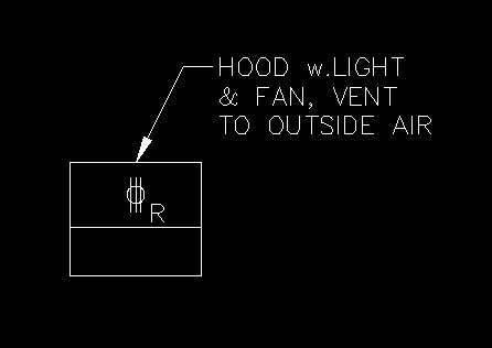

bego Posted April 1, 2014 Share Posted April 1, 2014 hi there, I am currently working on the elective project for electricaland electronic schematic drafting and I am now facing some difficulty in thekitchen. I would like to know how point 2 looks like. “It says that: Above therange is a hood with a light fan.” Because I cannot find the symbol for hood inmy study unit would like an illustration of how this connection looks like. Iwould also like to know if what I have done so far is correct. Thank you Maria Quote Link to comment Share on other sites More sharing options...
ReMark Posted April 1, 2014 Share Posted April 1, 2014 You don't need a symbol for a hood. In plan view the range would be shown as a rectangle with an additional line for the hood above. There will be a symbol for the 220 volt circuit for the range and I'd use a note that reads something like the following with an arrow pointing to the range. "Hood w/light & fan, vent to outside air". Quote Link to comment Share on other sites More sharing options...
