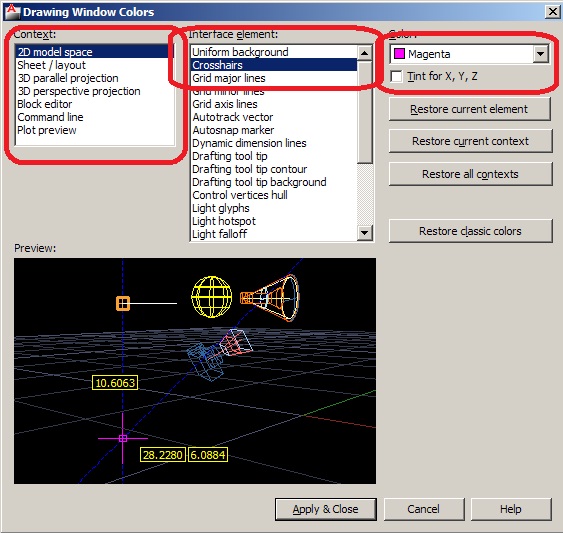

Building on RobDraw's instructions... In the Drawing Window Colors dialog, in the Context pane select '2D model space', in the Interface element pane select 'Crosshairs', then under the Color dropdown, check the box for 'Tint for X, Y, Z'.

Here is 2011 AutoCAD, Options>Display>Colors

Thanks for the screen shot, SLW. It makes things so much clearer.
The screen shot looks just like mine - not surprisingly. But note that one can only choose one color NOT multiple colors as in the 3D mode. My template opens in 3D isometric mode with three colors for the cross hairs which are at 100%. When I open two views and change the second view to a 2D view like FRONT or BACK, the cursor lines change to white or whatever color has been selected but both cursor lines are the same. Possibly the rational is that it is not difficult to "see" which is the X axis vs. the Y axis so multiple colors don't matter. I think they do.

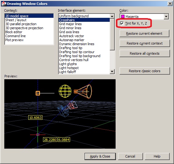

Yes, you are missing the "Tint for X, Y, Z" box. You cannot pick individual colors for each but you will see different colors for X and Y in your 2D view.
Do you have the "Tint for X,Y,Z" check box when you select cursor?
