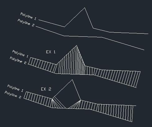

I like measure distance between polylines and I found nice visualLISP for starting point. This lisp make lines between polylines with can be measure.
But I have some problems:
1. In EX1 is new lines right angle but "step 50" is for polyline 1, I like that "step 50" is for polyline 2 like in EX2 but in EX2 is new lines wrong angle.
It's difficult to explain:)
2. New lines must be in red color
3. How measure these new lines
Thanks for all tips or maybe is something similar already made8)

In Example 1 the lines are perpendicular to Polyline 2 and in Example 2 the lines are perpendicular to Polyline 1.
It looks as though you need to consider which polyline should be picked first. It is important to the LISP routine which line is picked first.
Thank You for Your response!
Yes You are correct. I like Example 1 the lines are perpendicular to Polyline 2 but I need that "step 50" is also to Polyline 2 not Polyline 1. It's difficult.
You are more than welcome.
Step 50 is the distance between the lines on the first polyline that was picked, hence the two differnt situations. You can not have Step 50 on both polylines because it is mathematically not possible. In my opinion, it would be possible to do what you want but that would require the LISP routine to be rewritten and ufortunately I am not your man to do that. There are other members here on the forum that could do that.
Thanks anyway Tyke!

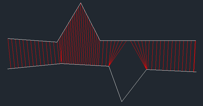

If you don't mind having the lines non-perp to either of the polylines, then it is possible. Perhaps try something like this:
(defun c:DrawLinesBetweenPollys  (/ dist poly1 poly2 dist1 len1 len2 getPoly2Corresponding clay)
 (or *DistBetweenLines* (setq *DistBetweenLines* 50.0))
 (if (and (or (setq dist (getdist (strcat "\nHow far between lines <" (rtos *DistBetweenLines*) ">: ")))
              (setq dist *DistBetweenLines*))
          (setq poly1 (entsel "\nPick first defining polyline: "))
          (setq poly2 (entsel "\nPick 2nd polyline: ")))
   (progn (setq poly1 (car poly1)
                poly2 (car poly2)
                dist1 0.0
                len1  (vlax-curve-getDistAtParam poly1 (vlax-curve-getEndParam poly1))
                len2  (vlax-curve-getDistAtParam poly2 (vlax-curve-getEndParam poly2))
                clay  (getvar "CLayer"))
          ;; Check if poly's are not co-directional - swap directions
          (if (inters (vlax-curve-getPointAtParam poly1 0.0)
                      (vlax-curve-getPointAtParam poly2 0.0)
                      (vlax-curve-getPointAtParam poly1 (vlax-curve-getEndParam poly1))
                      (vlax-curve-getPointAtParam poly2 (vlax-curve-getEndParam poly2)))
            (defun getPoly2Corresponding (d) (vlax-curve-getPointAtDist poly2 (- len2 (* (/ dist1 len1) len2))))
            (defun getPoly2Corresponding (d) (vlax-curve-getPointAtDist poly2 (* (/ dist1 len1) len2))))
          (while (<= dist1 len1)
            (entmake (list '(0 . "LINE")
                           (cons 10 (vlax-curve-getPointAtDist poly1 dist1))
                           (cons 11 (getPoly2Corresponding dist1))
                           (cons 8 clay)))
            (setq dist1 (+ dist1 dist)))))
 (princ))
Very nice code, but the new lines should be perpendicular and red colour.
Thank You for response!
To get them in red colour, add a line like '(62 . 1) somewhere into that entmake list. Or simply set a layer which has colour = red current before running the code (that would actually be my choice as I avoid drawing with overridden colours as much as possible - rather use a different layer and keep to colour ByLayer).
As for perpendicular, it's impossible to get what you're after. You're either going to end up with something looking like EX2 (in some cases - note it might happen somewhere along Polyline 2 also depending on its shape) or you're going to end up with lines crossing each other (which I think is not what you want). It's physically impossible to have lines drawn perpendicular to one polyline but eqally spaced between two. One of those rules will have to break.
Try drawing this manually and see if you can get at what you're after. If you can, then post that DWG here so we can understand what you did and calculate the lisp from that.

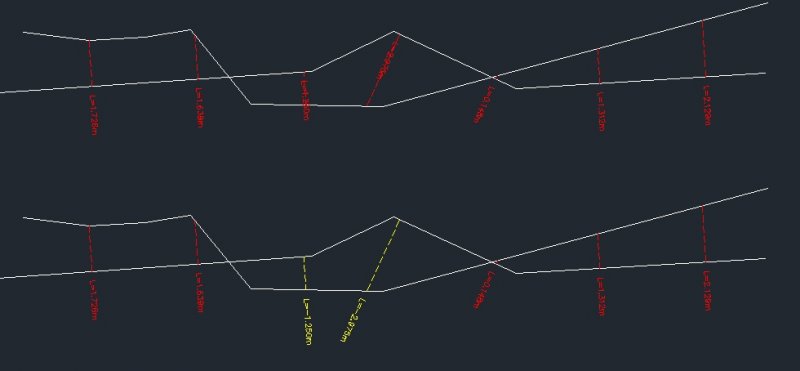

What I like to have is something similar like below:
The new lines is perpendicular to polyline 1 and and "step 50" is also on polyline 1 and then that lines measurements.
Thanks for going deeper into!
What I mean is how should something like this be done?
If the lines is shortest way to between polylines and step 50 is also to upper polyline (in last case), then it would be nice:) But how about dimensions, is it doable?
So you want a lisp which alternates between 3 possibilities:
  1. Always perpendicular to one of the polylines; or
  2. If the distance between the non-perp ends of the lines is less than the specified distance, then swap to be perp to the other polyline; or
  3. If lines are going to cross each other then use my method from post #6
Am I understanding correctly?
Sorry, what would you want with dimensions? Referring to the 50 units? Or do you somehow want to also place dimension in this somewhere?
It's ok if the lines going to cross each other but yes always perpendicular and "step 50" to first of the polylines.
I like to place dimension of the new lines like I show on my post 9.

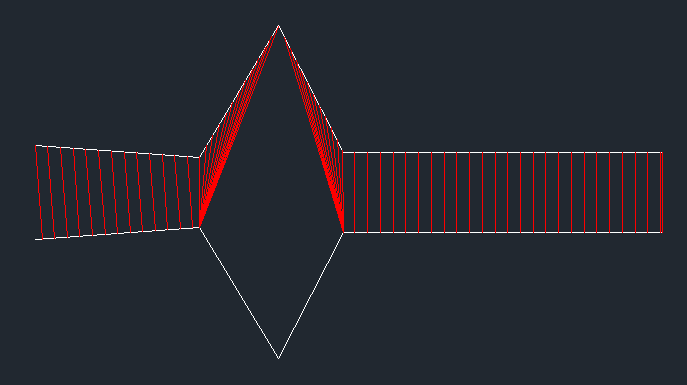

Unless I have misunderstood, perhaps try something like:

Or perhaps:

You are wizard Lee Mac! That is what i mean, but how to add dimensions like I show on my post #9. (like L=124.20m)
Cheers phoenix, see post#16 ;)
It's like christmas again and present for me :shock::shock::shock: Thank You so much!!!
But how to put all new lines and dimensions to layer "dimensions" and make them red color and linetype dashed2.
Is it possible write if statement for case when polylines is crossing each other. Make the lines yellow color and dimensions negative(see image below). That would be perfect!!!
You're welcome, you caught me in a generous mood ;)
The property changes are simple, the test for crossing polylines is not so simple:
