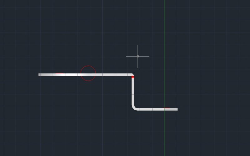

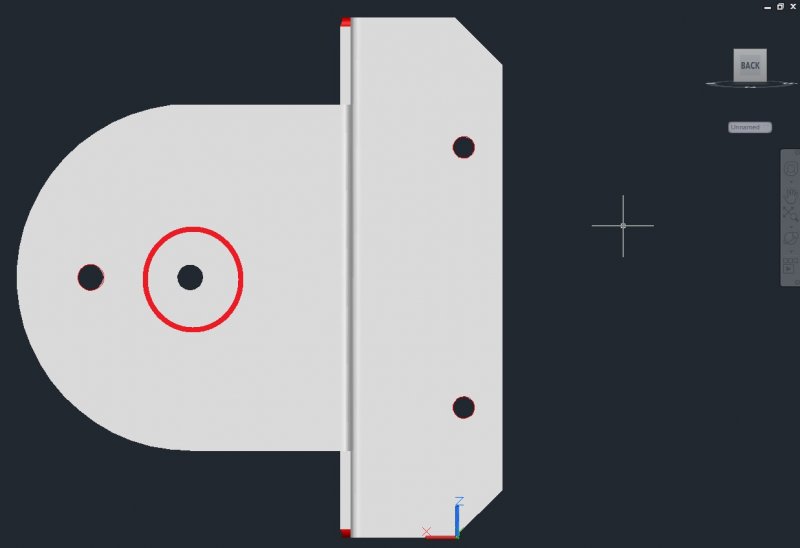

I have a drawing and I want to enlarge the circle (circled red with MS Paint :oops:) from rond 6 to rond 12.
But all things I've tried, it comes up with this:
I think it has something to do with the view I'm working in?
How can I simply correct this...
UCS and then Face option and click the face where you want to draw the circle.

This was also my intention. I made the model and put all the dimensions in the layout out. But when I finished the drawing, they wanted a change in the design. The metal bracket is used as a mounting frame for a small industrial light with a normal halogen bulb in it. But they want us to mout a replacement LED bulb instead wich mean an other bulb holder must be mouted wichfore the center circle has to be enlarged from the 6mm now to a circle (hole) of 18mm.

I am all around confused here. You keep referring to circle, but as far as I can tell what you are really trying to do is enlarge a hole (cylinder) on a solid in which case all you need to do is SolidEdit - don't even need another circle.
Yeah, I know I can be confusing sometimes :roll:
But you describe exactly what I mean. I want to enlarge the hole.
I have done it the way you mentioned earlier with changing the view using UCS and it worked for me.
Never used the command SOLIDEDIT so I will keep that one in mind to practice a bit with it.

There are several options (or icons on the ribbon) associated with editing solids (solidedit) at least two of which will allow you to resize a hole, and one that will allow you to move and one that will allow you to delete. Become very familiar with these tools.
and
depending on how your part was made and solidhist variable you might be able to simply change a number in Properties.
