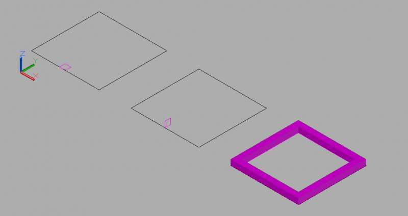

"I was trying to extrude around a square if that can be done."
Yes, it can be done. In the image above a 1x1 square is created at the midpoint of a 12x12 square. After the UCS is reoriented the 1x1 square is rotated vertically then it is extruded. Command = EXTRUDE with PATH option.

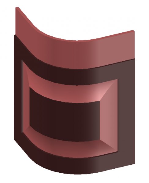

Example of a piece of moulding extruded along a curve.
Create it...orient it...extrude it.
Done.

So your telling me that not all lines drawn can be extrude or joined i'm still confused a little or do i need to moze the ucs every time i draw on a different elevation plane.
You are using AutoCAD 2006 so you do not have access to the PressPull command that can work on lines, arcs, polylines and splines and any combination thereof.
If you were to create a box comprised of individual lines and extruded it the end result would be four separate surfaces. The same box comprised of one continuous polyline or four lines/polylines that had been joined when extruded would yield a 3D solid.
I would recommend that any geometry you wish to extrude be done so based upon a closed (joined) profile otherwise you may not get the desired results.
