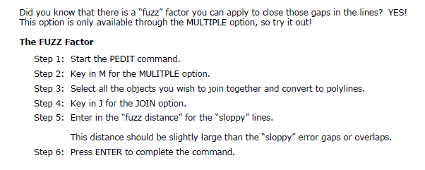

I am typing PE then M then J then then it is asking me to enter fuzz distance or [jointtype] : (which was not covered at CU) can someone please explain what is required at this point.

Read this. I'll post the source in a moment.
Source: Jeanne Aarhus - AutoCAD Secrets Exposed - A.U. 2005
Read my last post while I take a look at your drawing.
Are you having trouble with PEdit or Extrude?
Fuzz is a distance that the lines can be apart and still be joined.

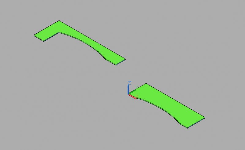

Now what piece of geometry were you trying to extrude along a path?
I see no "solids" but I do see 3Dfaces. What's up with that?
Seems that the edges of your contour doesn't lay on the same plan; on top-left corner there is a difference of 3/16. How did you draw them?
These are solids.

Visual style: Conceptual.
3D solid.

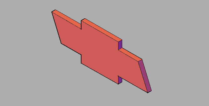

The Chevy emblem would be an excellent starting point. Draw it as 2D and attach the file here for next instruction.

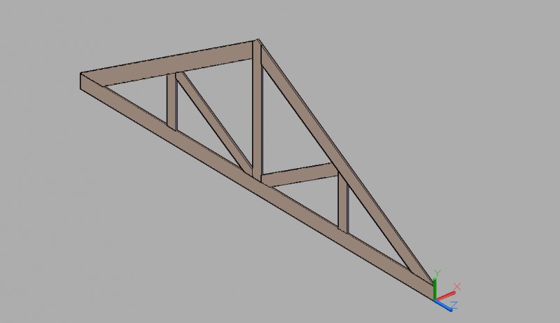

A portion of your truss drawing done in 3D as a solid.
Everything in your drawing was created using lines.
Edited by ReMark
The OP uses UCSFOLLOW
A portion of your truss drawing done in 3D as a solid...
Is that standard 2x lumber? (1.5x
Mine? Yes, I just used 1 1/2" for demonstration purposes. I think the OP is showing his trusses as 12".
Yeah, I opened up your Main Trusses 3D drawing and there are some issues there (as Remark has stated). I also agree that it seems you have picked up some bad habits that need to be unlearned brfore you can really go forward. My main complaint is that you have only added more work for yourself to make the file "look" correct.
Solid modeling is the way to go for this. Your sizes appear to be off in this drawing as well. The wood beam between the trusses has a size of 8" x 22". I think we can get you going in the right direction.
