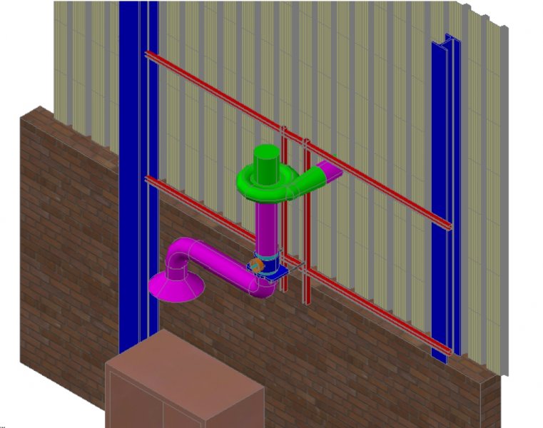

i'm pro-level 2D but pretty new-ish to 3D but that's not really a prob as i can get by with what i need to accomplish......i draw duct runs 1) for my own benefit so i can order correct quantities for the installers and i'm not caught out with obstructions/changes of level etc and 2) to give the installers some basic 3D views for clarity, as well as some flatshots for the various 2D views, annotated with the important details.
i draw in modelspace, then on paperspace layouts i create viewports, set them up how i want in various views. 99% have the views as 'realistic' and plot.
comes out fine in most cases but i know i missing out on lights, cameras and rendering. i add materials to solids and if i render they come out but there's often too much shadow and the resolution is rubbish (set on 'presentation' render quality).......the plotted paperspace layouts although much more basic (graphics-wise) usually look best.
tried messing with lights but they're a nightmare and make it worse
tried setting up a camera but that ain't easy.....and what do i do next?!
is it as complicated as it seems?
am i never gonna see the 'materials' without rendering?
how do i get more materials? i want steel, blockwork etc but there doesn't seem to be much in the tool palette.

Did you load all the materials that came with 2008 or just the sample materials?
You can create your materials if you can't find what you want.
No, you won't see any of your materials if you don't create a render. Not right.
You will see your materials if you use a Realistic visual style.

Nothing much atm. sometimes though when i do it the colours are too intense and it actually makes the drawing harder to 'read' and i think maybe things would look better rendered. eg the drawing i am on atm i have a 1/2 wall with cladding sheets above. there's a fan and some duct in front but it's not very clear. i will fling it up in a min.

not the best example, but you can see it's not brilliant. the fan and duct seems to get lost against the big blocks of colour that are the 1/2wall and cladding above.
looks like the 3D stuff was done in Word :lol::lol: ....but there is no end to the install work. i have to site visit, design, risk assessment/method statement, order materials, everything, bang it out and move on to the next one. AutoCAD has to be a tool to error-proof and also save time communicating. no time for the niceties unless they help to do that. clearer 3D views would help communicating what is required i think.

Looks like you used a "Conceptual" visual style. Is that right?

bingo!
appears materials don't show in models space, and not in paper as 'conceptual' visual style, but i clicked 'realistic' and wala!

Hi StykFacE,
thanks for the reply. I'm using 2008 (full) Electrical in vanilla form.
a few posts up is an attachment 'before'
'after' is below.
a massive step forwards imo :-)
would be very interested in any tutorials
(i am not colour blind btw, i was just playing with colours for clarity :-) ) and the pic is low res to enable posting here
