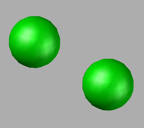

Bivek: Pictured are the same two spheres shown using a Realistic visual style. Which one is a 3D solid and which one is a surface?

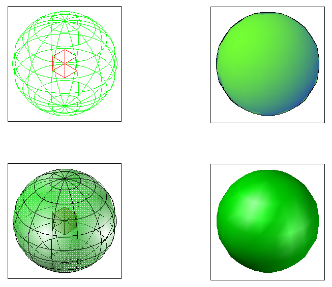

Four spheres each of which have a cube inside. Each sphere is depicted using a different visual style. Note: both the sphere and the cube are 3D solids.
Visual styles:
Upper left sphere - 2Dwireframe
Upper right sphere - Conceptual
Lower left sphere - Xray
Lower right sphere - Realistic
Bivek: Unless I told you otherwise or I outright lied how would you know if two out of the four spheres had a cube inside or not?

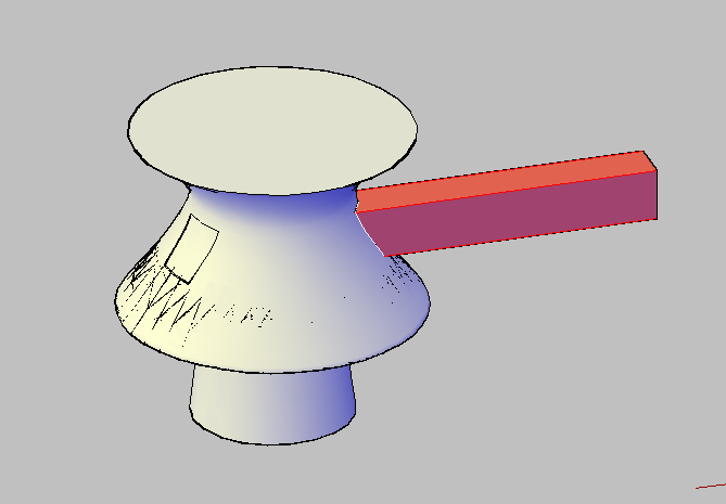

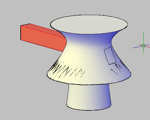

No no no you are not gettin me. I am not confused about the visual styles. All that I've tried is to know how to trim off a solid piercing through another solid and the solid pierced is irregular in shape(i.e i couldn't use the slice command). Its just like using intersect command but i wanted to keep one side of the piercing object. Sorry may be I've made it more confusing. See the marks of the trimmed box on the irregular solid. That's what i wanted. I think I've figured it out but yet seeking for a straight short way.
Edited by Bivek
There is no straight short way as each set of objects will introduce its own set of problems.
Use the SLICE command with the SURFACE option. If you don't know how to do it then ask for instructions. BTW...I demonstrated this technique already in a previous post so apparently you are still confused.

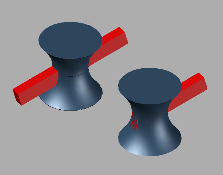

Before on left...after on the right.
How did I do it? I used the SLICE command with the SURFACE option.

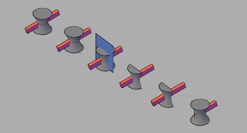

What you don't see in this image are the intermediate steps.

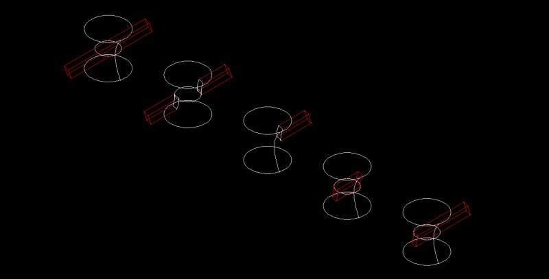

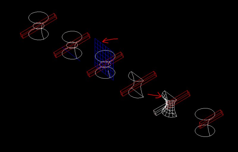

The intermediate steps are shown here.
Q: Is this the fastest way to do it? A: I don't know.
Q: Is there a better way to do it? A: There probably is but I don't have the time or inclination to figure it out. Since this is important to you I say that it is YOUR job to figure that out. Report back here with your results. A tutorial would be nice too. I think you owe us that much.
The two red arrows point to the surfaces used for slicing. After slicing I got rid of what I did not need and reassembled the objects for the final result. You are free to use any method that works best for you. This is but one option and not a very elegant one at that.

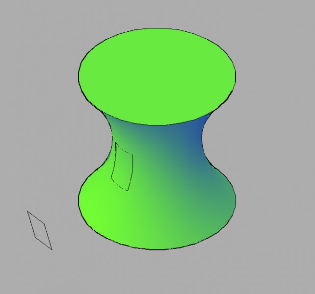

Taken literally - the Imprint command will produce those "marks" on the irregular solid.
bivek: End result of using the IMPRINT command. I left the profile of the object I used so you could see it. Do you know how this command works? The answer is not obvious.
