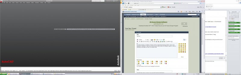

ive been having a number of issues with an imported drawing which i have now resolved. however i cant now see my icon menu when im trying to open or save a drawing. any ideas on how to resolve this
You lost the Quick Access Toolbar or the file dialog box?
