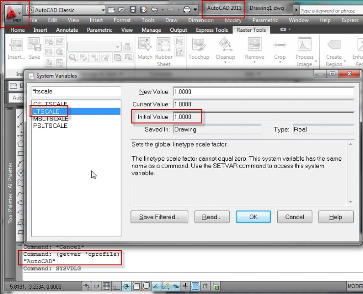

BlackBox Posted January 31, 2013 Posted January 31, 2013 ... Some further research revealed that AutoCAD vertical products have the default LTSCALE set to 0.5. As a vertical user since my first day of CAD, I've never heard of, nor seen this in my limited experience. I was curious, and so I checked Civil 3D 2011/2012, AMEP 2011/2012, and Land Desktop Companion 2009... All have an 'initial value' of 1.00 in OOTB Profiles. I started this discussion because my company recently upgraded from a much older version to MEP2011 and CAD management here has insisted that we use 0.5 because that's the OOTB setting. This seems borderline insane on his part because all of our standards are based on 1.0 and this change makes all of our linetypes show half the size that they were before. How can someone in that position make such a broadbrushed change without realizing the implications? So... Just set CELTSCALE = 2. Quote

BlackBox Posted January 31, 2013 Posted January 31, 2013 Although I did not check it personally, I did here it from multiple sources that 0.5 is the default. We are using AMEP2011 and I'm pretty sure he used an OOTB template with some minor adjustments. Not sure who your 'sources' are (or what they're looking at!?), but using the OOTB application icon, template, etc.: Quote

BlackBox Posted January 31, 2013 Posted January 31, 2013 Here's one. http://www.theswamp.org/index.php?topic=43696.0 See post #3. And #7. Lots of OOTB settings get changed immediately by the user, why should this one not be subject to adjustment based on what that office deems is best for their situation? To site post #7 of Rob's duplicate thread: My rule, use LT Scale 1 and make your line types plot properly with the definition, cause why in the hell would 0.5 be normal instead of 1? But thats just me. Quote
