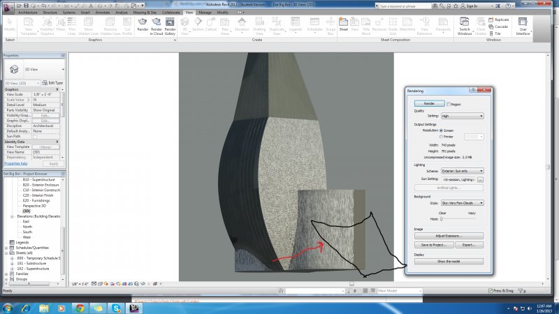

Hello guys,
I am new to revit and trying to create a planar surface on this building I have been working on.
I want to build a roof type item that intersects with my with my curvy surface as seen in the image.
I was wondering how I can define a work plane that I can place a roof on.
Also if one of you could help me bring the curvy lower surface together that would be great. I was unable to get the spline to close on itself so there is a gap in my structure.
I have tried attaching the file but I keep getting an error. If you would like the file I will continue to work on trying to fix this but for now I am taking suggestions.
Thanks guys.
Easiest method IMO would be to swap to a side view (say an elevation which would look perpendicular onto your roof). Then draw a Reference Plane at the angle you want to roof to slope. Select it and give it a descriptive name in the Properties Palette.
Swap back to your 3d View and click the Set Work Plane button - scroll through the list so you find the plane you just made. Continue drawing on that plane.

I have the work plane now, but what do you mean by sketch on it? I want to be able to place a roof type structure on it but it does not let me.
got it looking good now. very complicated to do in revit. maybe im just not used to it yet.
is there any type of trim command like in autocad to make the roof end where it intersects with the existing building? currently it extends into there but can not be seen in the picture

Select the walls, then there's an option in the ribbon for "Attach/Detach", then select the roof. It will trim the walls where they intersect with the roof.

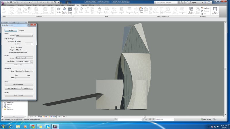

I see, I probably took a convoluted path to getting this roof though. I began by making a mass in place object and it would not let me directly sketch on the reference plane. I had to choose a elevation view which gave me the reference plane at an angle which is not what I wanted. I then had to edit the in place mass in a 3d view and make it snap to the reference lines I had drawn on the reference plane. Maybe there was easier way to do this?
