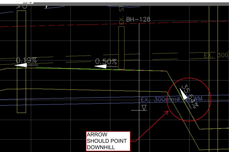

Does anyone know of a way to achieve what is shown in the attached image? I have added profile labels to display the line slope % and a slope/flow arrow. However, I would like the arrow to flip 180 degrees when necessary to point down hill.
Any ideas?
You would need to make an expression for the arrow block.
If the slope is negative, it will flip the block 180. Might have to do some more geometery in there but that is the jist of it.
Yes that did it, I made an expression with an IF statement for Rotation.
