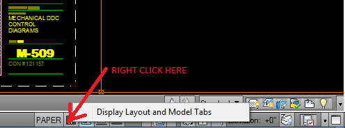

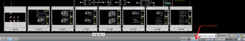

What do you see on the flyout menu when you right-click on the Model tab? Or don't you have that either?
Take a look at these screen shots.
The text says "LEFT CLICK HERE".
You can get the layout tabs back from the drawing Options window on the Display tab.
Edited by ReMark
[ATTACH=CONFIG]39813[/ATTACH]
[ATTACH=CONFIG]39814[/ATTACH]
I have the model/paper space tabs when I am in classic view but not in the 2D drafting & annotation. I do have an icon to quick view the layouts but it is easier to use the tabs.
You can get the layout tabs back from the drawing options window on the display tab.
Thank you. This worked!
