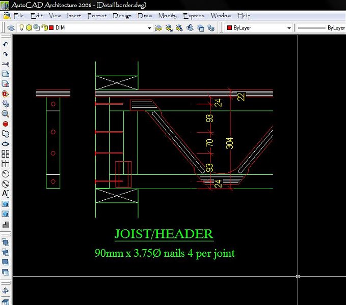

Leecox Posted November 12, 2008 Posted November 12, 2008 When i'm in modelspace I can see the text no problem, when I am in paper space I can see the normal text. However, the text in the view port can not be seen. Also the text from the dims can not be seen, even though the lines of the dims can. There are no boxes round the text.......there is just no text at all in the viewports. I have tried using a very basic text like ROMANS and it works. Also when I zoom right out I can see the text, but when ever I zoom in it disappears again. Help please.....its driving me insane!! Quote
soleary Posted November 12, 2008 Posted November 12, 2008 When i'm in modelspace I can see the text no problem, when I am in paper space I can see the normal text. However, the text in the view port can not be seen. Also the text from the dims can not be seen, even though the lines of the dims can. There are no boxes round the text.......there is just no text at all in the viewports. I have tried using a very basic text like ROMANS and it works. Also when I zoom right out I can see the text, but when ever I zoom in it disappears again. Help please.....its driving me insane!! Can you post the drawing? That would help. In the meantime, check that the text layer isn't frozen in the viewport. For the dimension problem, check if there are annotation scales applied (or not as the case may be). Depending on the view scale, you may be able to see the lines but not the dimension text (even if the dimension text is actually there). Quote
BOB'27T Posted November 12, 2008 Posted November 12, 2008 Is the text annotative? If so, check to see if the light bulb next to the annotative scale list is on. You can also check ANNOALLVISIBLE and make sure it is set to "1". Quote

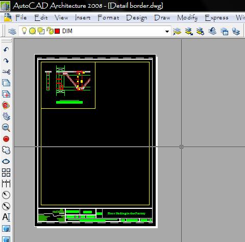

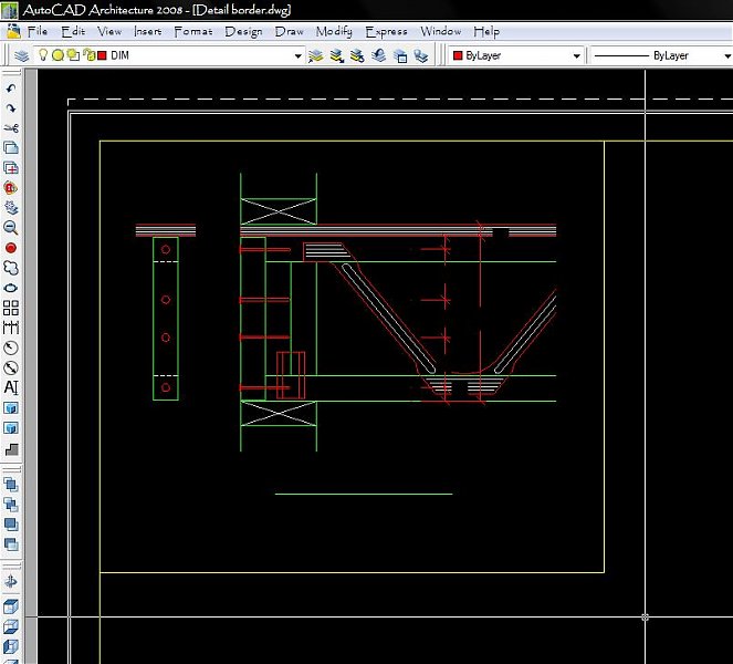

Leecox Posted November 13, 2008 Author Posted November 13, 2008 The annotation settings are fine, and no layers are frozen. I have opened the same drawing on another computer and there is no problem at all, which leads me to believe that it is a setting on my machine not the drawing. Also as I mentioned before, if I use a basic text such as ROMANS there is no problem, so it is not all texts that this happens with. I have attached screen shots showing the problem. it only seems to be in viewports in paperspace, but when I zoom right out the text appears to be there?!? Quote

profcad Posted November 13, 2008 Posted November 13, 2008 It sounds like you are having the same problem that I had. It's the clipped viewport. See the following post and it's solution. http://www.cadtutor.net/forum/showthread.php?t=28082 Quote
Leecox Posted November 13, 2008 Author Posted November 13, 2008 On Vista: Go to 'contol panel' - 'Personalization' - 'Window Colour and Appearance' Then 'Open classic appearance properties for more color options' - 'Advanced...' This will however change the fonts generally through windows. On XP, i think its very similar. Quote
Leecox Posted November 13, 2008 Author Posted November 13, 2008 Ha ha!! problem solved, I tried the disable desktop composition but that didnt work, However, the viewports were clipped....so I disabled them and it seems to be working fine now. Thankyou very much!! Quote

Leecox Posted November 14, 2008 Author Posted November 14, 2008 The disable desktop composition has worked, i can now draw poly viewports and see the text inside. However, some of the graphics on vista have switched to basic. Quote
