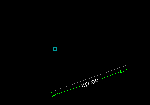

Hello,

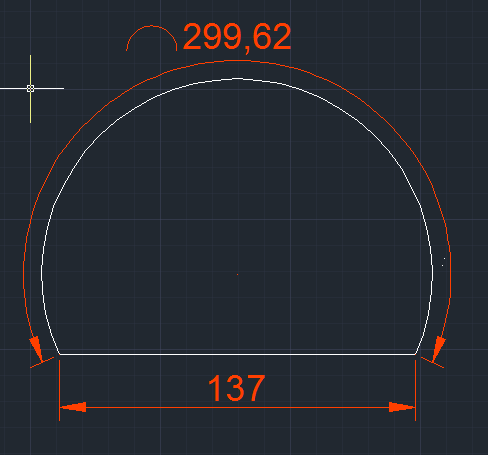

I have been trying to draw an arc with exact length and diamter but with no good result. arc.png You can see the image. Now, I want the diameter to be 137 mm and that was easy to draw :) To draw an arc is not difficult BUT I can´t seem to find how/where to input the exact length that I want. In my case I want it to be 297 mm and NOT 299.62 as shown in the picture. Also ONE extra question: Why can´t I use Properties to change the length of this arc?
I hope someone will help me with this I guess easy problem.
Thanks in advance and best regards to you all,
Miro

Use the LENGTHEN command with the Total option.
The line that is dimensioned as 137mm is called a chord, NOT a diameter :(
You drew a chord of 137. Is that what you wanted, or did you want 137 for the diameter? You can change the radius in the Properties. I do not know how you might change the length via Properties, but you cannot hold the angle and the radius and yet change the length, thus AutoCAD would have to know or decide on its own what to hold if you have several editable interdependent parameters.
You can use the Lengthen command. Use the Total option, input the new length, then select the object, in this case an Arc. Try it. It shortens/lengthens the end you pick closest to.

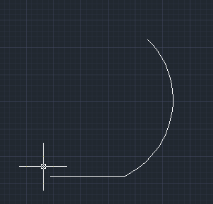

Thank you for your quick replay. Yes I did mean chord and not diamter, my fault. And YES I want the chord to be 137 mm. I tried command LENGTHEN but I guess I must be doing something wrong. So here is how I do it.
I draw the line 137 mm, then I choose arc (3-point),select those 3 points and make the arc longer then 297 mm. So now I type LENGTHEN sa command, press T
write 297, select object (arc) and then I get a funny looking arc funny arc.png
Thaks for helping

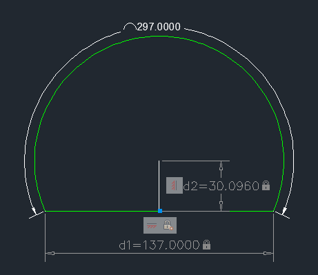

Perhaps this can not be easily drawn in AutoCAD. Try Googling for solutions and you could come up with this.

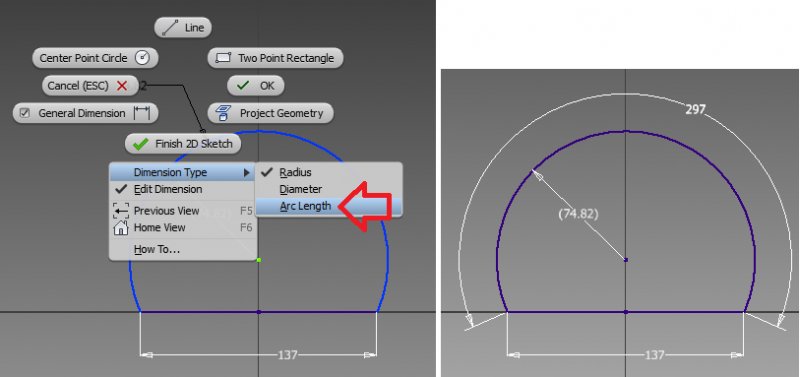

In Autodesk Inventor this is rather trivial as Inventor as a Parametric Arc Length dimension tool.
You could easily set up Parameters in AutoCAD to do the same thing.
I will try to post an AutoCAD example later.
Arc Length.jpg The dimension in parenthesis means the radius is a driven dimension, or reference, not a driving dimension.

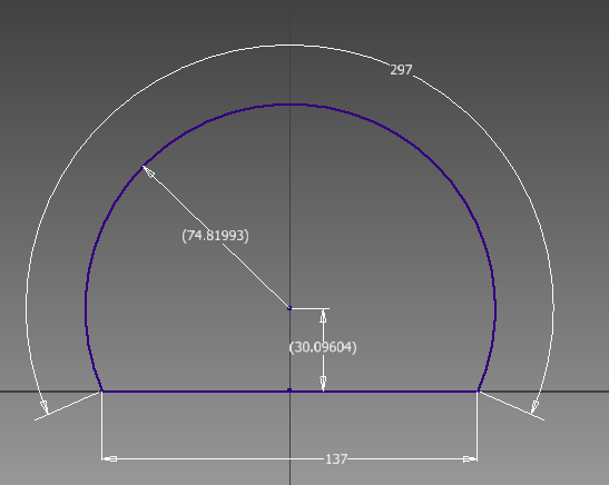

a bit more reference information if you don't want to take the time to set up Parameters in AutoCAD
I didn't take the time to set up the full parametric relationship (so that any (valid) arc length can be specified).

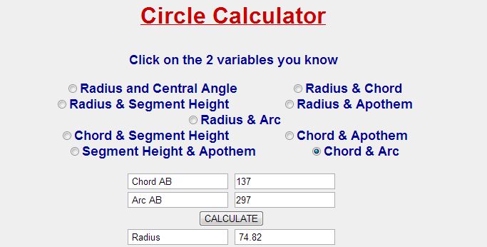

But the rest of the thread is proving of interest to me, as I've unsuccessfully dealt with the very option being offered here via Circle Calculator, etc.
:shock: :o Jesus...JD Mather...no comment...thanks,wow
This is good, eldon. This has the Chord&Arc option I've been referring to in another thread. But now it looks like you're saying it's not so easy after all, even to draw.

JD, your Inventor solution looks great! I’m not sure how you got the arc to be 297 in AutoCAD, unless you were using results from Inventor, or from the Circle Calculator. I’ve not yet seen where you can constrain the length of the Arc to a user input value or a fixed one. In general, I’m not seeing how you constrained your figure to give the desired output without already knowing what it is supposed to be. If you could elaborate, that would be appreciated. Thanks in advance.

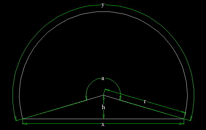

If you label the geometry in the following way:
Then
   y = ar
  a = (2π - 2tan^-1(x/2h))
=> y = (2π - 2tan^-1(x/2h))r
And:
   r^2 = (x/2)^2+h^2
=> r   = 1/2sqrt(x^2+4h^2)
Therefore:
y = sqrt(x^2+4h^2)(π-tan^-1(x/2h))
If you can rearrange the above equation for h in terms of x & y, then you can solve the problem algebraically.
Dang Lee, I was hoping you would to that last derivation :)
Must involve some hyperbolic cosines and natural logs.
I missed a trick!
After a bit of research, I discovered that equations of the form derived above cannot be solved algebraically, but you can use Newton's Method to solve the following relationship numerically:
<chord-length>/<arc-length> = sin(x)/x
This method is described here.
