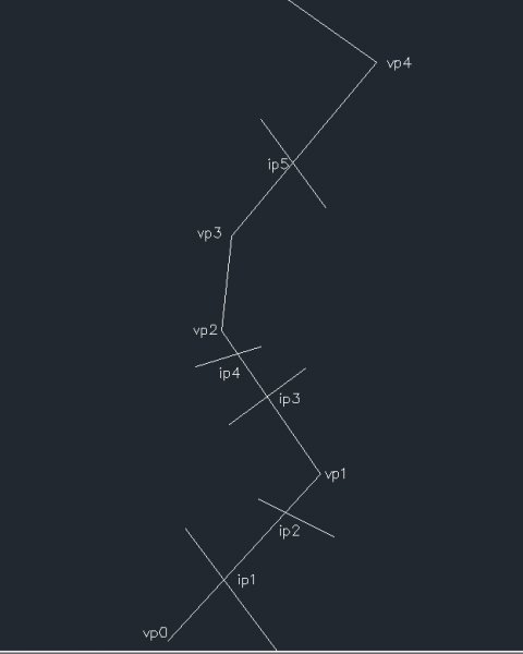

I need to calculate distance between two points along a polyline. These points may exist on different segments of the same polyline. Maybe there is a function, I couldn't find it.

Tharwat : I used vlax-curve-getDistAtPoint function but I get nil. i.e. (vlax-curve-getDistAtPoint plObj ip5) where ip5 is an intersection point on pline.
BIGAL : With my lisp code, I have all the intersection points and the verticies. I only need to calculate distance from vp0 to ip1, then vp0 to ip2, vp0 to ip3 and so on. The path must be followed vp0-ip1-ip2-vp1-ip3-ip4-vp2-vp3-ip5 points for length of vp0-ip5, ie. As you guess, the points may vary case to case.

Yes, the vlax-curve-* functions are extremely finicky about points being "exactly" on top of the polyline. Usually even snapping to it is not enough. Thus you use the vlax-curve-getClosestPointTo function to convert your point to something "exactly" on top of the PL - as Tharwat's shown.

Yes, it is working correctly with the vlax-curve-getClosestPointTo function. e.g.
(setq distance (vlax-curve-getDistAtPoint plObj (vlax-curve-getClosestPointTo plObj (list (car intP) (cadr intP) 0.0))))
