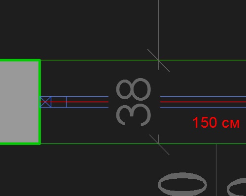

Grrr Posted May 22, 2016 Posted May 22, 2016 Awesome, Lee! One tiny problem I've noticed: The mask is covering the dimension line, can this be an easy fix ? Quote
Lee Mac Posted May 22, 2016 Posted May 22, 2016 Grrr said: Awesome, Lee! Thanks. Grrr said: One tiny problem I've noticed The mask is covering the dimension line, can this be an easy fix ? This is controlled by your Dimension Style - the offset of the text from the dimension line (DIMGAP). Quote
Grrr Posted May 22, 2016 Posted May 22, 2016 Lee Mac said: This is controlled by your Dimension Style - the offset of the text from the dimension line (DIMGAP). Oops, my bad! By the way, these syntax waves of your codes are very inspiring! I wonder how you do not get lost while writing such long programs. Quote
AndruxaZ Posted August 2, 2016 Posted August 2, 2016 Hello everybody. I have a problem with this code on dimension. I have localized (russian) Autocad 2012 x32. Command: BMASK Select mtext, mleaders or dimensions: Error: incorrect DXF-group: (-3 ("acad" (1000 . "DSTYLE") (1002 . "{") (1070 . 340) (1070 . "22A") (1070 . 144) (1070 . 1.0) (1070 . 173) (1070 . 1) (1070 . 344) (1070 . "22C") (1070 . 343) (1070 . "22C") (1070 . 283) (1070 . 1) (1070 . 40) (1070 . 25.0) (1070 . 69) (1070 . 1) (1002 . "}"))). You can solve this problem? Sorry for the bad english. Quote
AndruxaZ Posted August 5, 2016 Posted August 5, 2016 Hello Lee Mac. My apologies for the long absence Attach a file Test.dwg Quote
AndruxaZ Posted August 5, 2016 Posted August 5, 2016 I have installed add-in to the Autocad - SPDS GraphiCS 8 - http://www.spds.ru/about/spds-graphics/feature.html This application is written ObjectARX I noticed if the add-in is not running, your utility BMASK works. Sorry for my bad English Quote
