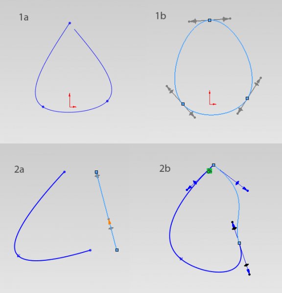

mrbump Posted January 19, 2013 Posted January 19, 2013 Hello everyone, new guy here. I'm having problems sketching a closed spline with a corner. Think of a drop shape for instance or an airfoil cross section (which is what I'm actually trying to do). As soon as you close a spline, the first/last point gets rounded as well. And I can't find a way to get the spline handles of a point to act independently. I can do this: 1. Draw the shape in two separate halves (splines) 2. Connect the bottom end of the drop, where it should be rounded 3. Make the two splines tangent 4. Connect the upper pointy end of the drop --> spline handle of the upper point now behave independently from each other. There are some problems with this though: The spline handles at the bottom of the drop are now fixed The tangency icon actually moves next to the joint which is not tangent at all - this makes me think I'm doing something that should not be done. Does anybody have a suggestion how this can best be done? Thank you in advance. (Sorry if there is an obvious solution to this. I'm a bit of a SW newbie - and google was a bit unhelpful on this issue) mrbump Quote

mrbump Posted January 20, 2013 Author Posted January 20, 2013 Thank you very much for your efforts welldriller. Unfortunately we seem to have a bit of a compatibility issue as I just can't get my solidworks to draw autocad splines... Anyway, it made me realize that my question seems to be a bit unclear. So, what I want to do (using SolidWorks 2011) is draw cross sections of an old airplane propeller and then create a surface. These cross sections are closed curvy lines with the exception of the trailing edge which is a corner or pointy. For those people that have no idea what I'm rambling on about I introduced the substitution with a drop shape. I made a few screenshots to illustrate the process: 1a: This is what I want to get to, but it's not closed yet (I'm in the middle of drawing it, but the mouse pointer didn't make it onto the screenshot). 1b: It's closed now but it magically turned into an egg. The intuitive thing would be to declare the upper point a "corner" - but I can't find a way to do it. 2a: I was toying around with some workaround ideas how to get there. Dividing up the single closed spline into two splines, then moving and connecting the dots. 2b: Making the two splines tangent actually only makes one end tangent and puts the tangency relationship icon next to the end that isn't tangent. But the real problem is that the direction of the spline handles is now locked. I would like the handles to behave naturally - ideally they wouldn't even need manual tampering. Quote

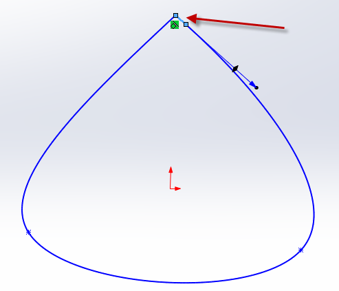

JD Mather Posted January 21, 2013 Posted January 21, 2013 Is there any portion (no matter how small) at that connection point that can be linear rather than a spline? (on one side or both?) Quote

mrbump Posted January 22, 2013 Author Posted January 22, 2013 Thank you for your suggestion. This will probably be a reasonable work-around given the not so preciseness of the project. I'll give it a try and report back. Alternatively I might just give the pointy end a certain thickness using a straight line or an arc. (I wanted to create the loft razor sharp and fillet it afterwards, but I guess it can also be done beforehand). Just for my general understanding: Is it correct then, that there can be no corner in a single spline (where the two handles move independently)? Additionally there is no way to have a tangency relationship between two splines that allows the spline handles at the joint to behave in a natural way (as with points within a spline)? Thanks again mrbump Quote

JD Mather Posted January 22, 2013 Posted January 22, 2013 (I wanted to create the loft razor sharp... That is the geometric description of two lines. Why can't you simply use a line at the beginning and end of the spline? Sounds pretty obvious to me? Quote
mrbump Posted January 22, 2013 Author Posted January 22, 2013 Well, it is the description of two lines that can also be curves. And I'm sometimes a pedantic purist... Anyway, as I said, if the workaround is the only way to go I'll gladly live with it. I just wanted to make sure I didn't miss the simple "real solution". Thank you for your help. Quote
