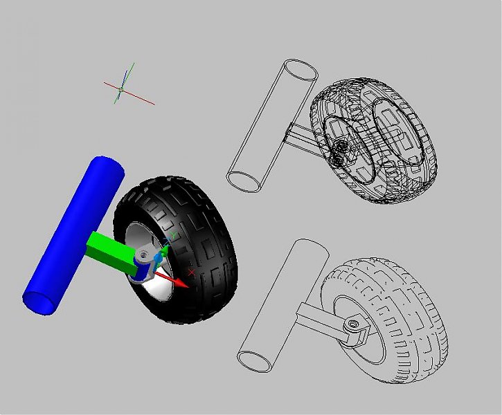

shift1313 Posted November 12, 2008 Posted November 12, 2008 flat shot works fine for me. Im not sure if the prompts have changed but here is a screen shot of two flatshots i used on this wheel/spindle i made just to who you. One has Show obsure lines, the other does not. can you provide a screen shot of what you are trying to do? Quote
