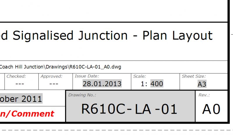

woodman78 Posted January 28, 2013 Posted January 28, 2013 I was having trouble in our office where people were duplicating an A1 layout and changing the scale to A3 to create a version for printing at A3. The problem arises then that there are now 2 layouts and a change will be made in one and missed in the other or something like that. This is storing up big problems. I had to nip it in the bud so I created 1 layout in A1. This is the only size layout that we use even though we now do the majority of our printing on A3 and not A1 as we did when I set the system up. The scale is set on the layout in a field that is tied back to the PlotScale and the Viewport Custom Scale. The used selects from a drop down on the ribbon to print in A1 ot A3. As part of the lisp all fields and force updated. This means that the scale is plotted based on the sheet size. I also plot the sheet size on the plot. I have found that this solves a lot of problems. Even if templates themselves need to be updated then they are less to be updated... Quote
