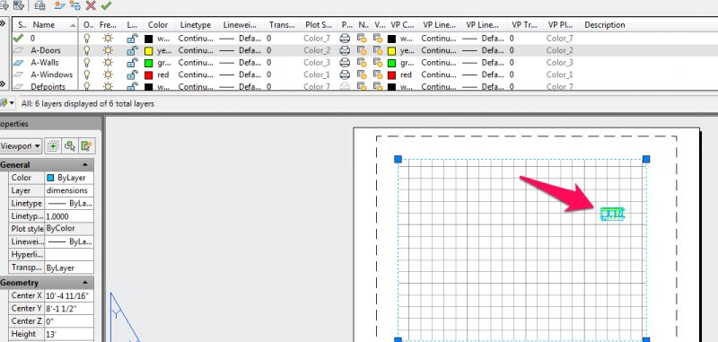

I want to print my finished floor layout but
this layout view tab (layout 1) show me a tiny drawing I want it to cover all the A4
format
how to do it please ? thanks

Double click inside the viewport.
This should take you into model space, but constrained to the viewport itself.
Now you can zoom in on your model.
Without knowing what units and paper size you are using, and the size of your model -- it's impossible to suggest a scale factor that will look right.
But the main thing before you start experimenting with scale factors is to get your model centered in the viewport.
See also: http://ltisacad.blogspot.com/2007/08/setting-viewports-scale-in-layout.html
Open your Properties Palette.
Click on your viewport frame.
Look on your Properties palette, under the heading Misc, find where it says Standard Scale.
Use the arrow at the end of the box (unseen until your mouse pointer is over it) to display the scalelist.
Choose a scale.
After having done so adjust your viewport if need be then lock the display.

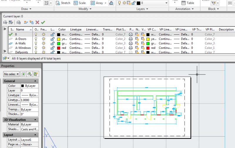

I double clicked the viewport and then I accidentally scroll the wheel of my mouse, after that I tried to find my drawing and using just the wheel I zoomed in
, navigated with the center click on the wheel and try to put it into the frame
Am i Good to go ? I'll try your method Remark see what i got and feedback
I would say the answer to that is "no". Why? Because my guess is your drawing is currently not to any recognizable/standard architectural scale. Basically you have scaled it to fit. This might be OK for you as long as you realize you cannot scale any measurements off of it. Your choice.

The risk with only doing those steps is that the contents of the viewport are scaled using the center of the viewport as the zoom point.
So if the model is not centered, it is possible and even likely that after a scale is selected, the model will not be visible - confusing new users.
Many times I will use the old school method of
Zoom>Center
pick a point near the center of the model
enter the scale factor, like 1/40XP
In any case, it is good to know the size of your model, the size of the paper, and what scale will allow the model to fit the paper...
