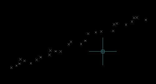

I have a family of points that resemble a straight line – those points were coming from a third-part application and, due to its low precision, they doesn’t lay on a line, even if they should – please refer to picture below. I’m trying right now to design an algorithm to rebuild a straight line from those points.
I will appreciate any suggestions/solutions on this matter.
Thank you very much for your attention
Linear regression could probably do it although it might not be easy to program.
Agreed, look into the Least Squares Method.
Thank you for your suggestions, Gentlemen. I will investigate the math behind those theorems to see if I'm able to implement them in AutoLISP.
Since you only have one dependent and one independent variable, you can use Simple Linear Regression...

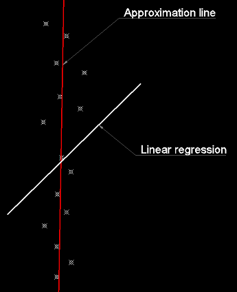

Salut Mircea
Linear regression assure that the sum of differences between a series of values (e.g. y) and the approximation line is minimum.
It is working good if data meet some criteria.
For example, set your points around a vertical line, then use simple linear regression (like Lee's lisp. BTW Lee, your code is amazing).
Here is my lisp, using a formula from another (surprisingly) domain.

Multumesc mult Stefan pentru solutie! Thank you a lot Stefan for your solution.
Although the results of the two routines are slightly different on a scattered set of points, both give excellent result for the data that I have to deal with.
Thank you again Gentlemen for your valuable support.

In the context of the original question I believe Stefan's solution is superior as it
does apply an orthogonal regression to the line and minimize the distance of the points to the line.
Lee's solution (Outstanding implementation) is a different beast and minize the distance along the Y ordinate to the line and is totally correct when the X is considered an independant variable.
Solution to this problem was first published in The Analyst, Vol. 5, No. 2 (Mar., 1878 ), pp. 53-54Published by R. J. ADCOCK.
Here's a link to this paper : A PROBLEM IN LEAST SQUARE
It is also known as Deming's regression or Orthogonal's Regression.

     (while (<= I (- LISTELENGDE 1))
       (setq ELEMENT (entget (ssname LISTE I)))
       (setq X (cadr (assoc 10 ELEMENT)))
       (setq Y (caddr (assoc 10 ELEMENT)))
       (setq SX (+ SX X))
       (setq SY (+ SY Y))
       (setq SXY (+ SXY (* X Y)))
       (setq SX2 (+ SX2 (* X X)))
       (if (= I 0)
           (setq XMIN X)
           (setq XMAX X)
         ) ;_ end of progn
       ) ;_ end of if
       (if (> XMIN X)
         (setq XMIN X)
       ) ;_ end of if
       (if (< XMAX X)
         (setq XMAX X)
       ) ;_ end of if
       (setq I (+ I 1))
     ) ;_ end of while
   ) ;_ end of progn
 ) ;_ end of if
 (setq A (/ (- SXY (/ (* SX SY) I)) (- SX2 (/ (* SX SX) I))))
 (setq B (- (/ SY I) (* A (/ SX I))))
 (setq X1 XMIN)
 (setq Y1 (+ (* A X1) B))
 (setq X2 XMAX)
 (setq Y2 (+ (* A X2) B))
 (command "line" (list X1 Y1) (list X2 Y2) "")
) ;_ end of defun
;***** END RUTINE: LIN
; Linear Least square fit of 2D points
(defun Lsq_pL (  pL  / xmin  xmax  kA  kB )
  (setq X 0   i 0   kX 0  kY 0  kXY 0  kX2 0
        XMiN  (car p)   XMAX  XMiN  )
  (foreach p pL
    (setq x   (car p)    kX (+ kX X)
          y   (cadr p)   kY (+ kY Y)
          kXY (+ kXY (* X Y))    i (+ i 1)
          kX2 (+ kX2 (* X X))  )
    (if (> XMiN X) (setq XMiN X) )    ; X min-max vaLs
    (if (< XMAX X) (setq XMAX X) )  ) ; pL
  (setq kA (/ (- kXY (/ (* kX kY) i))
              (- kX2 (/ (* kX kX) i))))
  (setq kB (- (/ kY i) (* kA (/ kX i))))
  (List (List XMiN (+ (* kA XMiN) kB))
        (List XMAX (+ (* kA XMAX) kB)) )   )
Prodromosm,
I know this one, it's from Cadalyst and does Ordinary Least Square.
This is not ideal in you want to fit a line to point that you survey.
The one by Stefan is better for that.
The new one is for fitting in 3D and will also work with a 2D line,
however could be more sensitive to roundoff. I have not checked.
ymg
