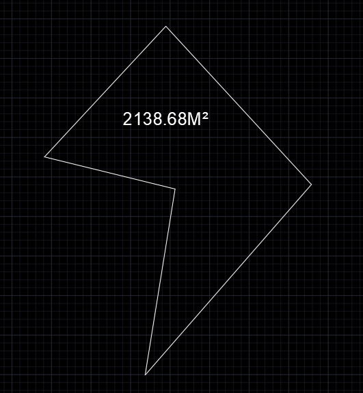

  On 1/19/2013 at 2:47 PM, GP_ said:
J’ai adapté mon code ici + la routine de Lee.

  On 3/10/2024 at 8:22 AM, DELLA MAGGIORA YANN said:
hi dont load for me
error arrond expression
Expand
 Try this below. I found the error of a missing parenthesis and number in the LM:LWPoly->List function.  Tested and works.
(if (equal der '(0.0 0.0 0.0) 1e-8);;<--- Missing parenthesis and fuzz expression was here.
Full code:

@DELLA MAGGIORA YANN Easily. Change the following line; it will convert from millimeters to Meters and adds a unit string "M2"
;;From this:
(cons 1 (rtos (vlax-curve-getArea poly) 2 2))
;;To This:
(cons 1 (strcat (rtos (/ (vlax-curve-getArea poly) 1000) 2 2) "M" (chr 178)))
;; OR Alternately - since this will be easier to read and you can easily use other units later:
(cons 1 (strcat (rtos (cvunit (vlax-curve-getArea poly) "mm" "m") 2 2) "M" (chr 178)))
OR - If you don't want the units string:
(cons 1 (rtos (cvunit (vlax-curve-getArea poly) "mm" "m") 2 2))
Edited by pkenewell

Merci ça a marché
mais pour avoir des M² j’ai remplacé la division valeur 1000 par 1000000
((cons 1 (strcat (rtos (/ (vlax-curve-getArea poly) 1000000) 2 2) « M » (chr 178)))
merci encore c’est super
j’apprends petit à petit
  On 3/12/2024 at 8:32 PM, DELLA MAGGIORA YANN said:
Merci ça a marché
Translation:
Thanks it worked but to have M² I replaced the division value 1000 by 1000000 ((cons 1 (strcat (rtos (/ (vlax-curve-getArea poly) 1000000) 2 2) "M" (chr 178))) thank you again it’s great I learn little by little
Expand
@DELLA MAGGIORA YANN Yes - you're right my apologies. I got the conversion factor wrong - I was thinking in length instead of Area 😜. As I noted with the alternative, you could also use (cvunit):
(cons 1 (strcat (rtos (cvunit (vlax-curve-getArea poly) "sq mm" "sq m") 2 2) "M" (chr 178)))
Which does the math for you.
Edited by pkenewell
